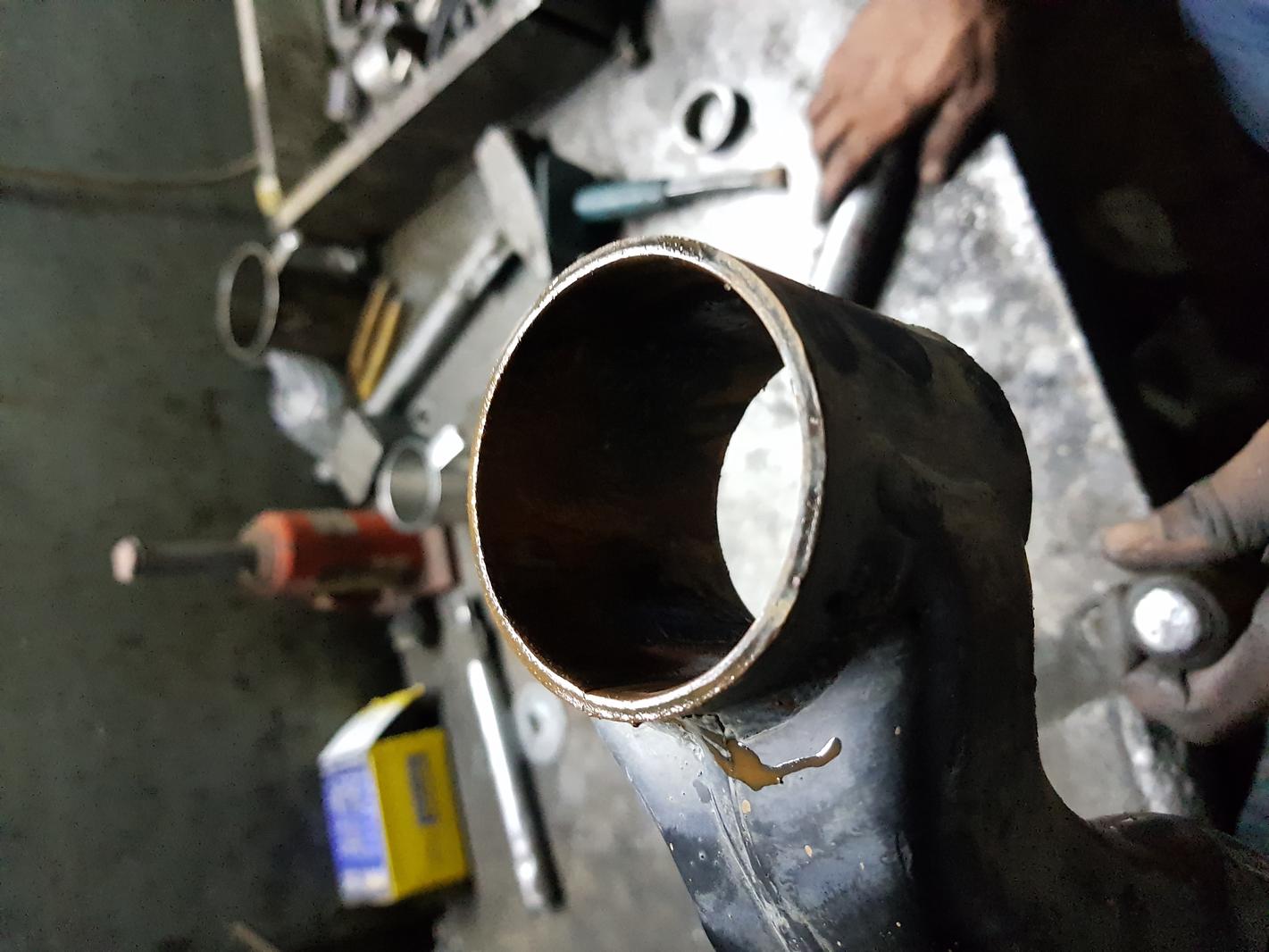

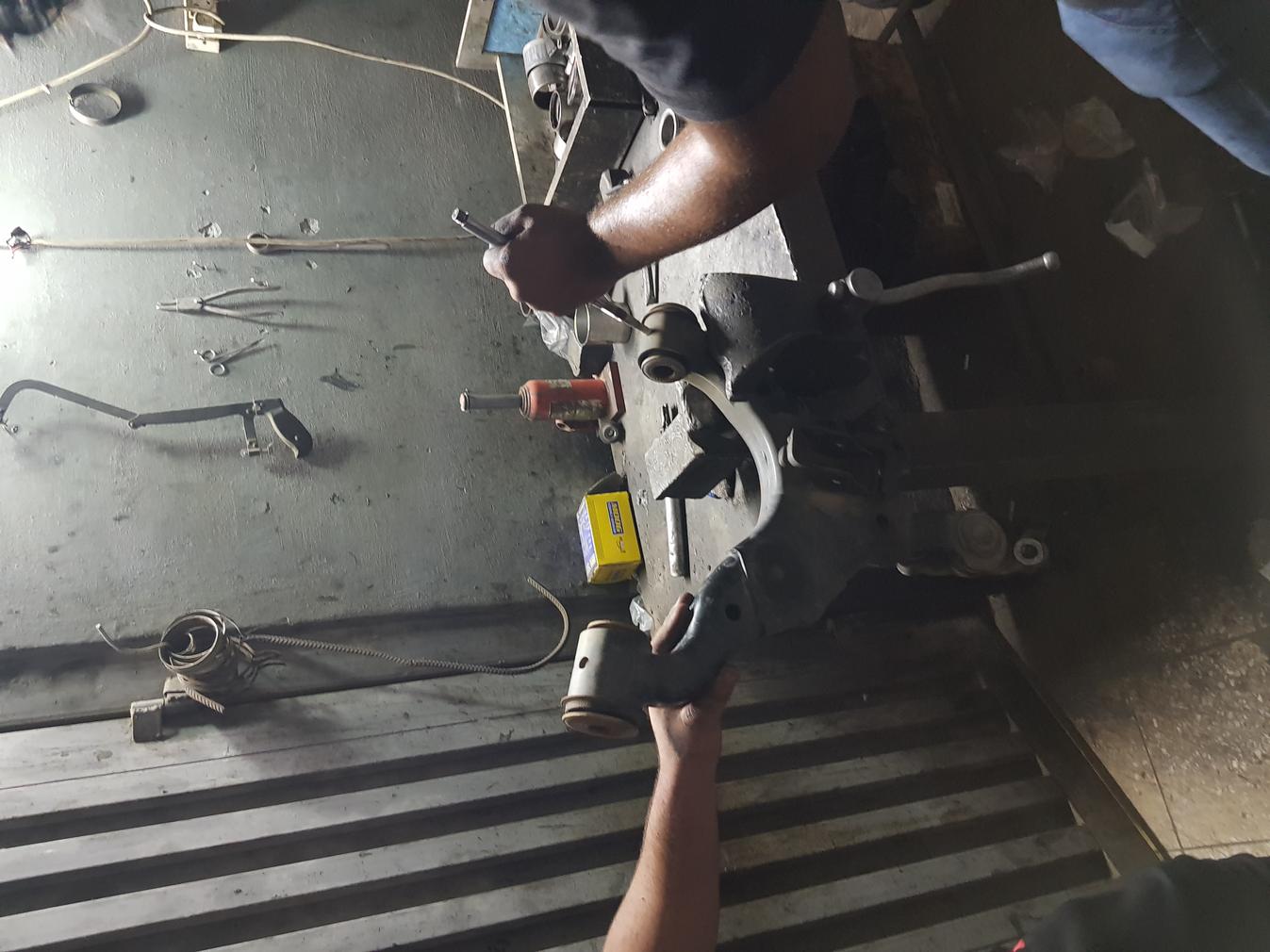

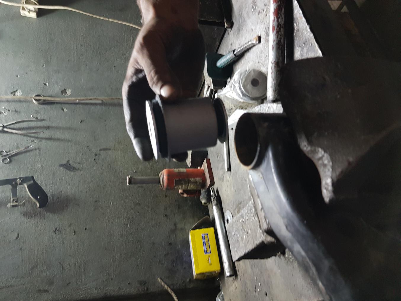

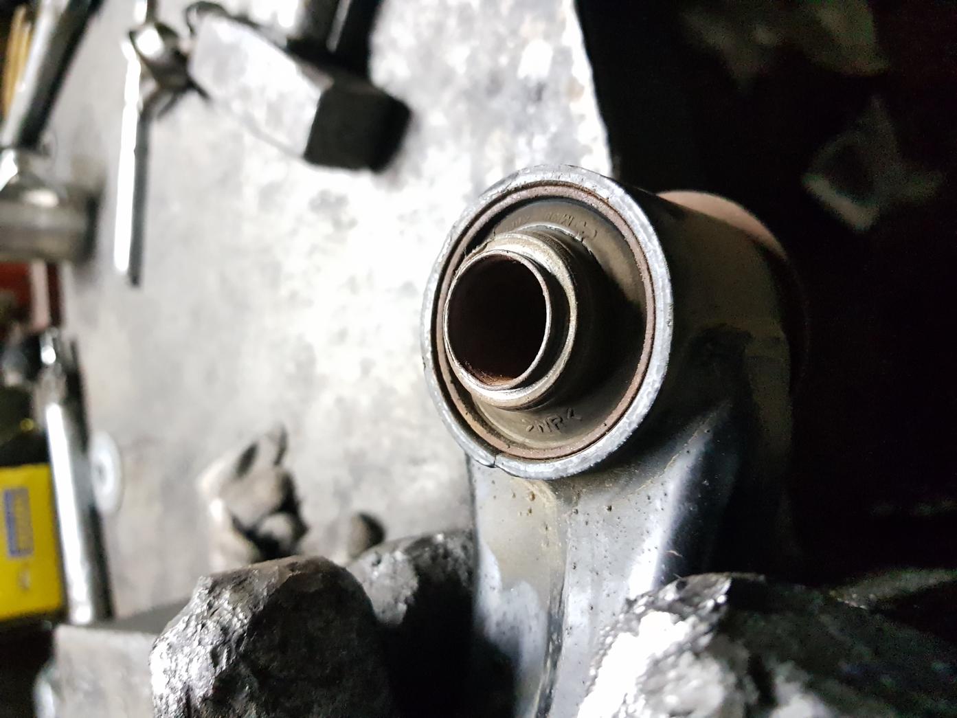

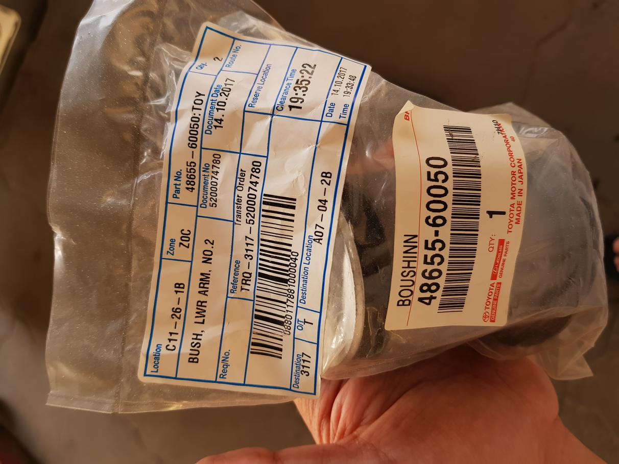

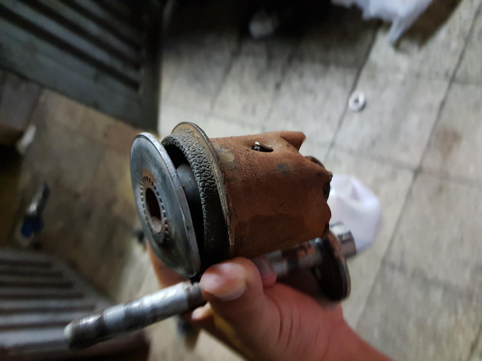

UPDATE -- SOLVED!
So we went through everything once more (cleaned/ tifgtened/ tested) and figured out it was the LCA bushings gone bad. The rear one was in worse shape and that cam bolt had some of the threads damaged too which was a pain to remove. Bought 4 new bushings, 1 cam bolt and did both sides as it made sense to freshen everything up.
Once it all bolted back on (KDSS sway bar was a REAL pain) no more clunks and she drives nice and smooth! Case closed.

I was too. Fortunately that's not true.

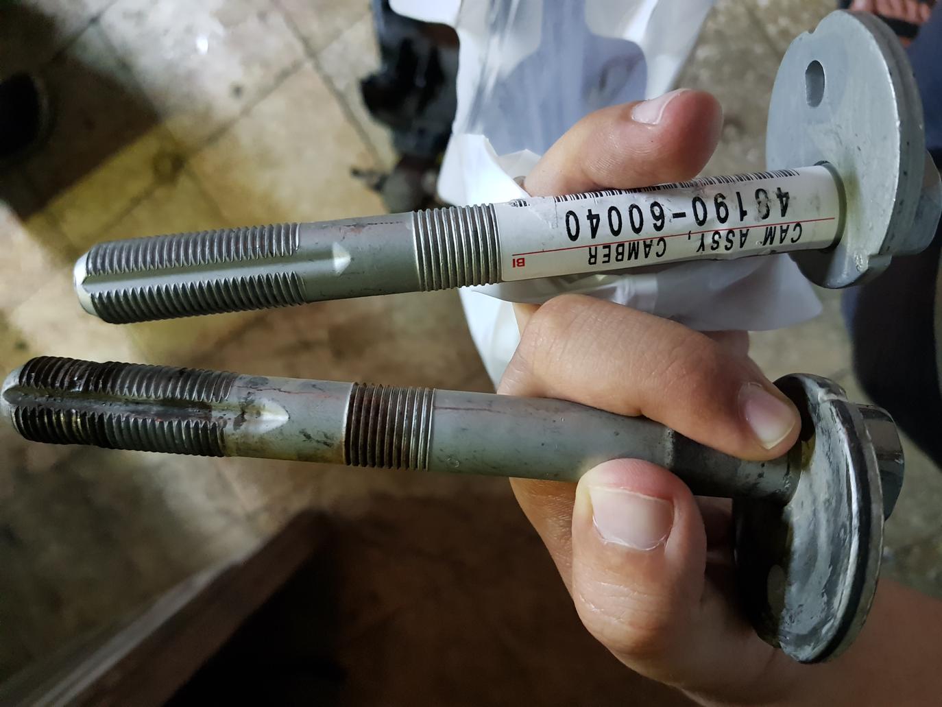

Turns out the bushings and cam bolts are not KDSS model specific parts. They actually fit all recent 4Runner and FJ models alike so pretty easy to find.
The bushing itself is a complete unit that can be hammered out of the LCA as you see above. It takes a few tries and you will ruin the old ones in the process of removing them. The new one just slides in with an easy tap.
Not hard at all. Each bushing cost me around $50 so that's $200 for all 4 plus $10 for the new cam bolt. The LCA itself was solid so no need to waste money changing it just for bad bushings.

I went through the same process first. Then took it to a friend's shop and did a quick test on both sides as follows:
Found an open area and did a couple go-stop runs with a spotter looking at the suspension and LCA. He stands driver side and I turn left, press hard on gas then hard brake several times while he checks. Then did the other side.
He noticed the driver side LCA was moving back and forth horizontally along with a clunk. Good bushings should be holding it solid and only allow for up/down movement (for suspension travel)
The bad bushings we're allowing the LCA to move excessively in a horizontal motion which results in the clunk as metal contacts or binds
Although only my driver side was bad, I did both LCAs just so I don't have to open the other side later on
