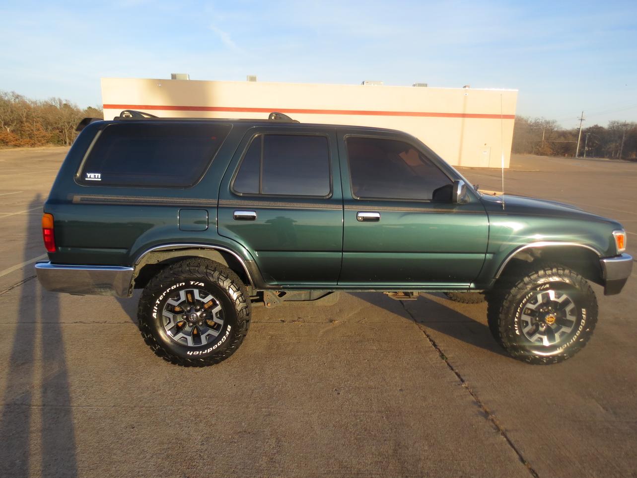

Have a 2006 Sport Edition and a 95 2nd gen. 2017 Tacoma 16" rims fit on the 95 but would not fit on the 2006 since has the larger calipers and rotors.. whomp whomp

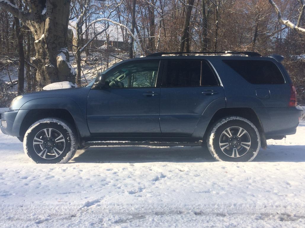

I replaced my 2005 SR5 stock 17" rims, with 17" rims from 2016 Taco Sport. They fit perfectly with no suspension or wheel housing alterations.

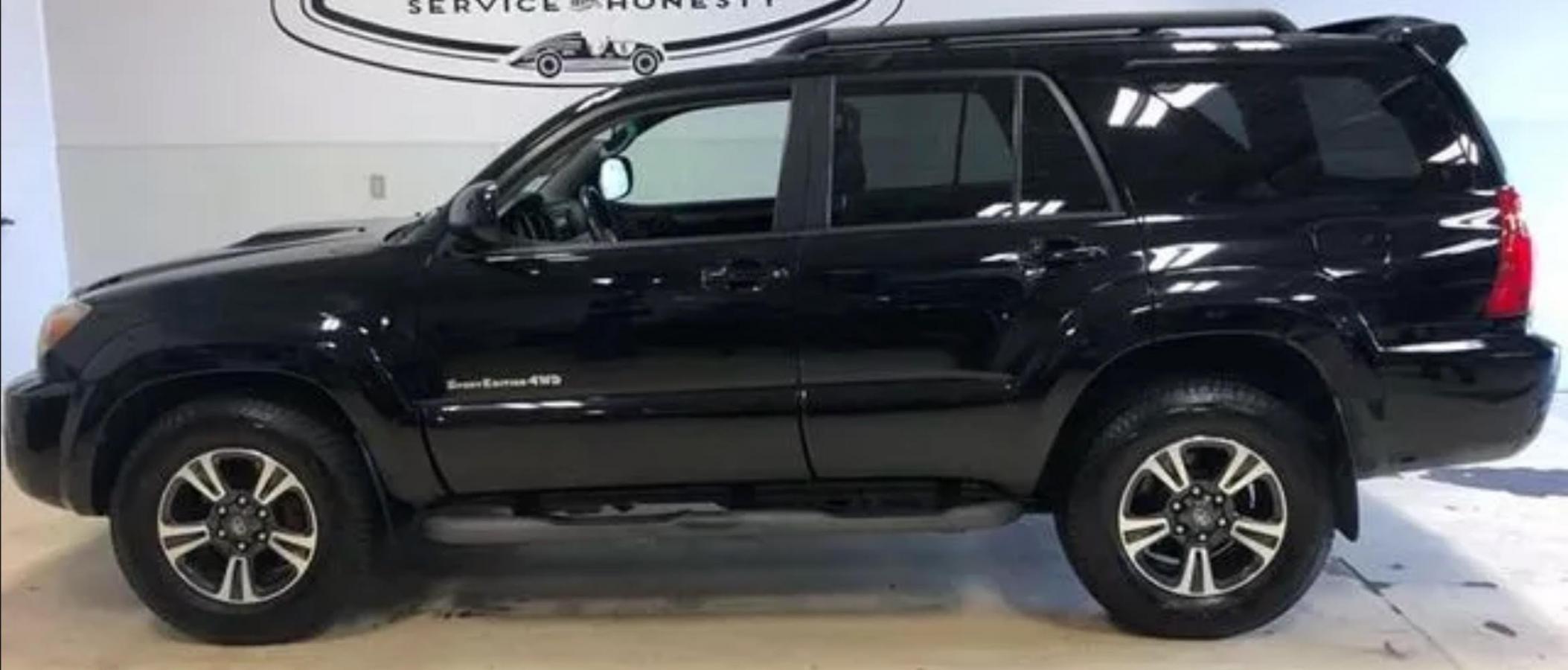

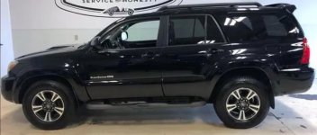

Here's mine. Came with them on when I bought it. I hated them on the Tacomas. But they look great on black 4th Gens. Lol.
Sent from my SM-G930V using Tapatalk
