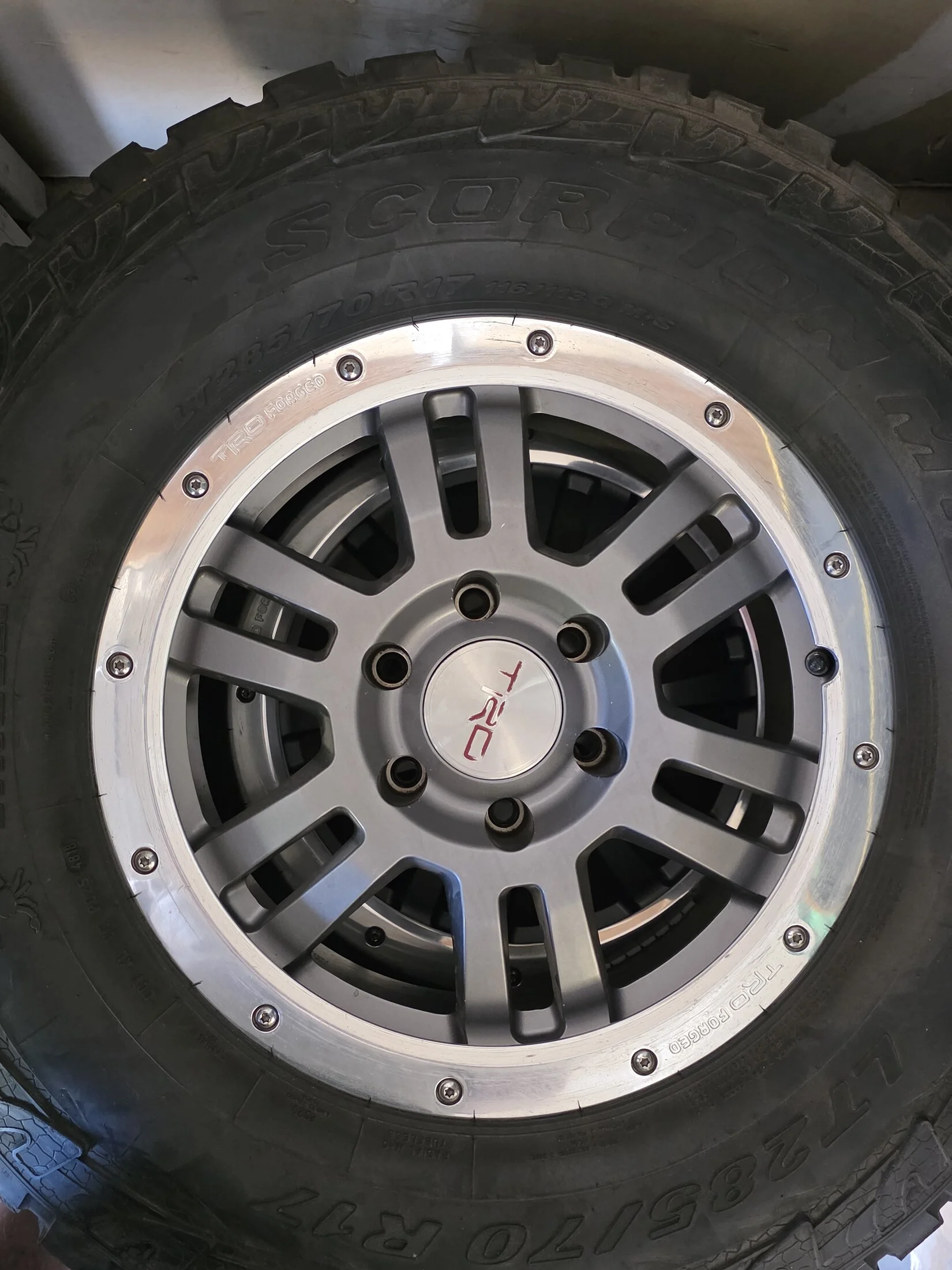

Anyway, I picked up the set, they bolted on and cleared the Tundra calipers. Deciding on what tires to mount on them.

They fit, went with Toyo RT Trail tires in 275/70r18 XL. These tires are only 43lbs each! Added E&E Off-Road replacement rock rings.
