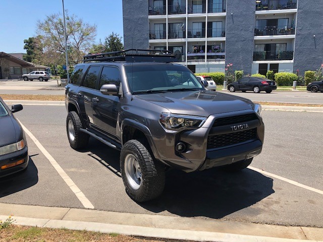

Im on 17x9 -38 F5's with 33's. and i run them with 1.25" spacers..
Post a side profile that setup sounds sick, albeit really far out.
Also, what center cap do those F5s use? Looks almost like the old FJ Pro TRD caps.
Cant find a side fitment shot, but I don't think its far out at all. But then again, I'm probably just used to it.
