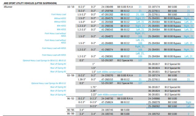

K Don't hate on the post buttttttt. I have a a nice 88 SR5 Manual 4Runner that i have purchased 2" BJ spacers (from the fella on here that is recommended) and OME rear leafs CS009R.
I want to run a set of Billy 4600's on it. Anyone know which model number for the rears that would provide the extra 2" (or close) of extra length?
Doing 33x10.5's on stock aluminum wheels.
Promise to post apres.
Bilstein Online Catalog
Screen shot from the catalogue. I think they want you to get 5100s for extra height.
But only seeing two part numbers for the 4600 B46-0056 for older jeep applications and then the one they list for the stock runner , b46-0046
