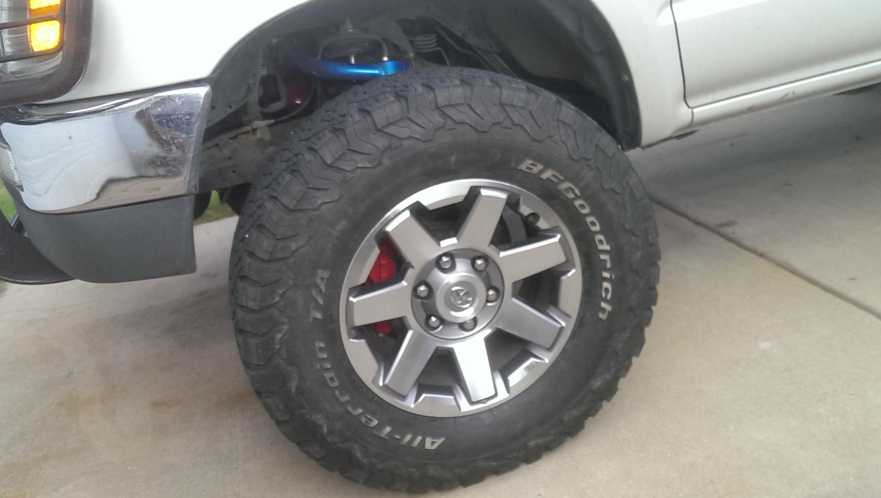

Nice color! I have the same wheels, but I put 1.5" spacers on it.
You can get the spacers at autozone, oreilly, pep boys, advance auto, checker auto, kragen...you get the idea.
They're either 2 or 4 per pack. I cant say whether the 231s are better but I figured if I were going to do it, go big. When it comes to brakes, bigger is better.
Also, theres a reason Toyota stepped up to a bigger caliper. Also, the 231s came on more vehicles so its more common and more readily available as far as parts go.

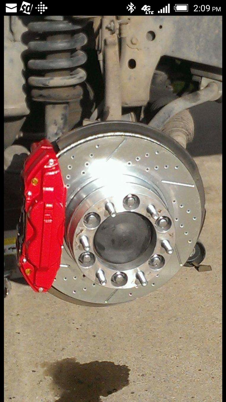

Pricewise, I got cross drilled and slotted rotors, Red powder 13wl calipers and ceramic pads (should have gone standard, but...) for 280 after core return from brake motive or callahan...cant remember but i think theyre the same company. No wobble, no warpage in the 2 years they've been on there
I hope this helps. Let me figure out how to upload pics
Pics of the upgrade. 2014 FJ trail edition wheels as well
