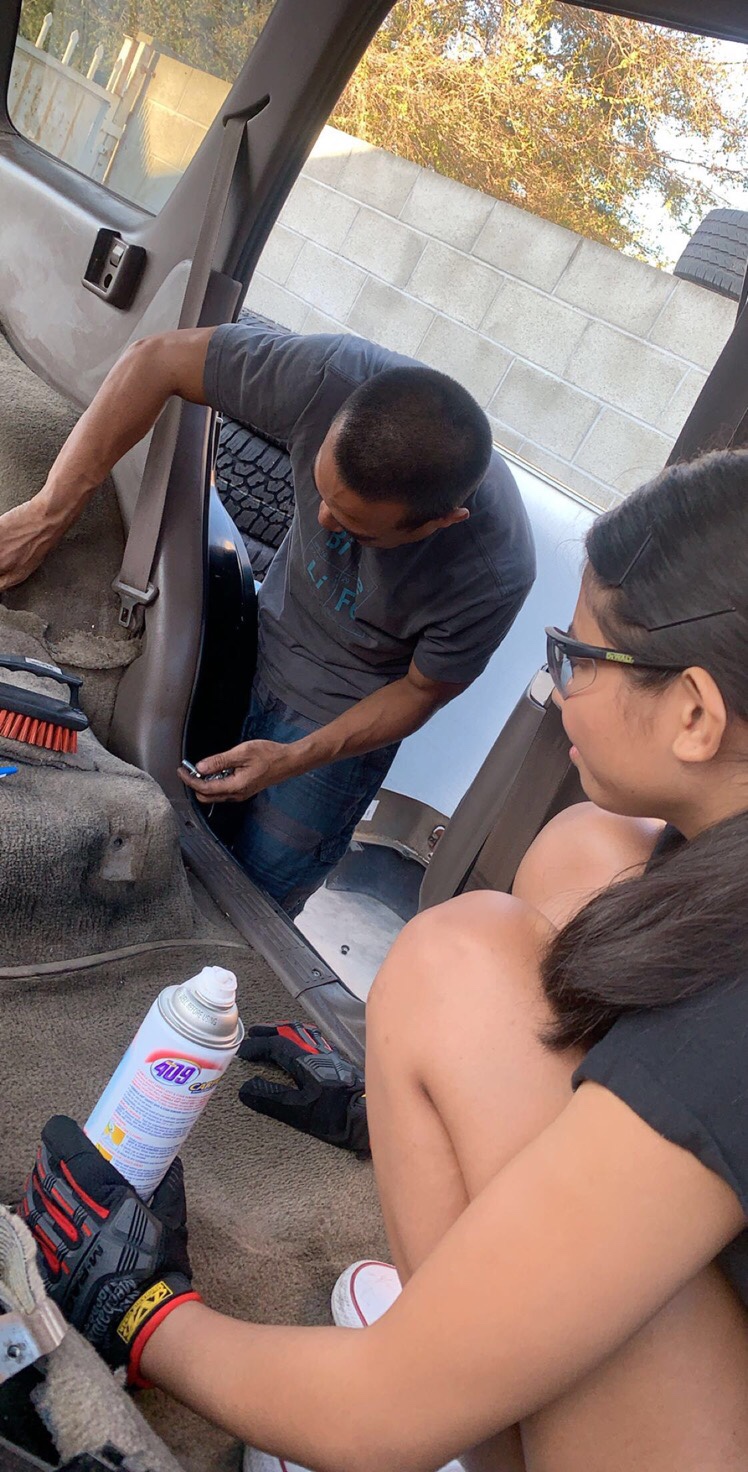

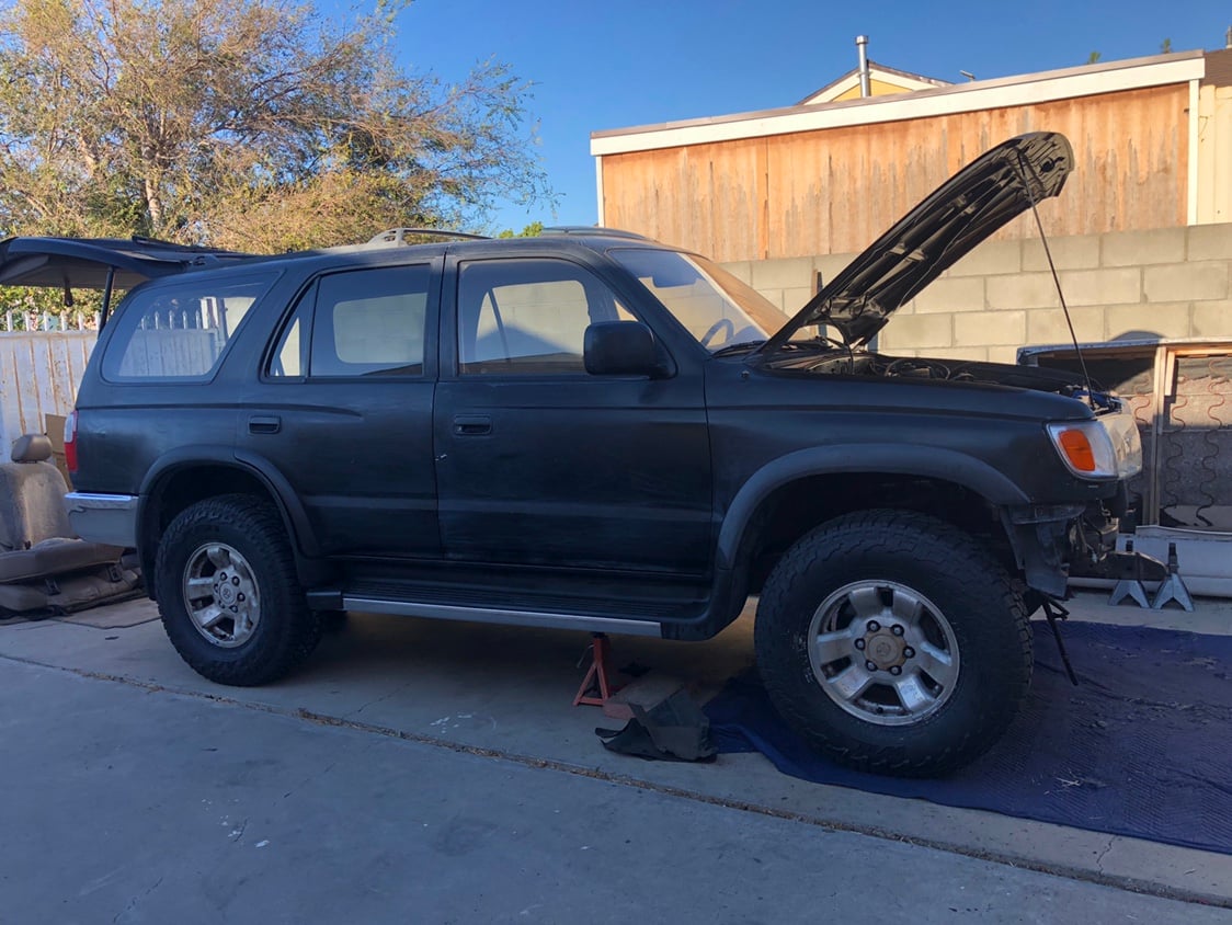

Thank you all for the positive support! We really do appreciate it! It's a slow and sometimes aggravating process, but we are enjoying it... so far at least lol
Quick Update.
We gave her a valve cover gasket job along with timing belt / water pump.
I read about this on the forums lol, It barely moved, but enough for me to use a cheater bar with the breaker to fully break the bolt free.
