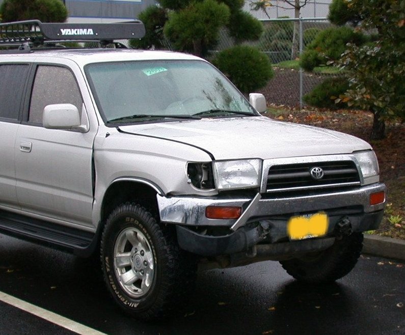

To add to this, the guy who is walking me through the process of Farmers Insurance at the bodyshop is telling me the agent for Farmers is coming out Friday to overlook the damage. The bodyshop is telling me the 4runner is on top of a fence right now and could fall either way of being totalled or fixed. Its all up to the the amount of money the Farmers agent wants to put into labor of pulling the frame. For advice to all with 4Runners. DRIVE SLOW WHEN TURNING!!! This was my fathers baby. He passed away 09/10/2005. This truck has so much sentimental value to me right now that this is just a nightmare to me. I hope he will go with fixing the 4runner because I just installed a KENWOOD DDX-8017, Kicker L5, Kicker RS speakers all around, and was going to install while in the bodyshop an ARB front bumper(painted the color of the truck), a Revtek 3" lift, and a K&N intake kit. I hope this all comes true. My dad would be very happy with the out come. I'm pissed off at the wet weather right cause when it pours it pours.

They have totalled-it-out for the frame needs replacement. Man oh man!!! What now, I'm in such a loss for words right now. Well, I will hear from Farmers sometime next week for figures and their ideas. Anyways please write and tell me your experiences, so I can help mine. I looked at the bump stops today. They are big and on the outside of the springs. Near the tires. I'm really irritated now, since the recall was never performed. Hmmm...
