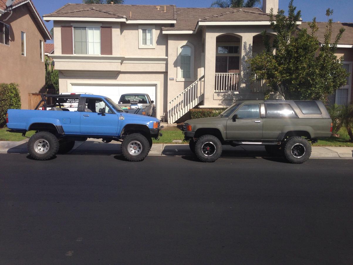

Wind wing windows were a options level thing ie sr5 dlx turbo. Just like chrome grills and chrome metal door handles on all 1st gens. The factory power window trucks did not come with wings ever. I believe. Here is a pick of my brothers 87 turbo with power windows and my 87 sr5.

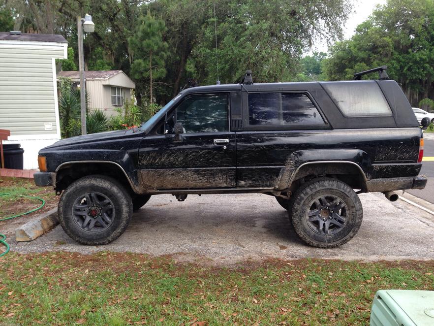

I used '96 moog rear coils, and Ive turned the torsions a little. Going to do BJ spacers at some point. Probably at the same time as ball joints and bushings.

Sweet, I just got a set of Moog rear coils for a '98 to use and a pair of BJ spacers from 4crawler. Still kind of unclear as to how much lift to expect. Your rig looks pretty good, though.
I got about 2" of lift over stock in the rear. Im expecting these springs to settle a little which is why Im waiting before I order new shocks. I am looking at 2" bj spacers but from what I understand the spacers alone do not give 2"s. The rest comes from cranking the torsions. I really dont want to crank my torsions much and make it "bouncy" so perhaps ill get the 3" spacers and either leave the torsions alone or maybe beable to relax them a little bit back to stock but still have decent droop. Been trying to set it up to ride real smooth since ive got a GF and 10mo old kid that like to come along.
