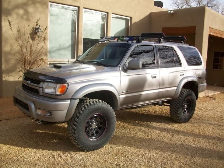

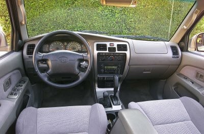

Color keyed front and rear bumpers and grill, Sport hood, Sport Edition emblem on the front door, big flares, but no body cladding, and silver interior trim.
And someone correct me if I'm wrong but I believe they also have a higher gear ratio in the rear diff, for a bit more low end torque. I know, that's not something you can tell by looking at it, just throwing that out there.

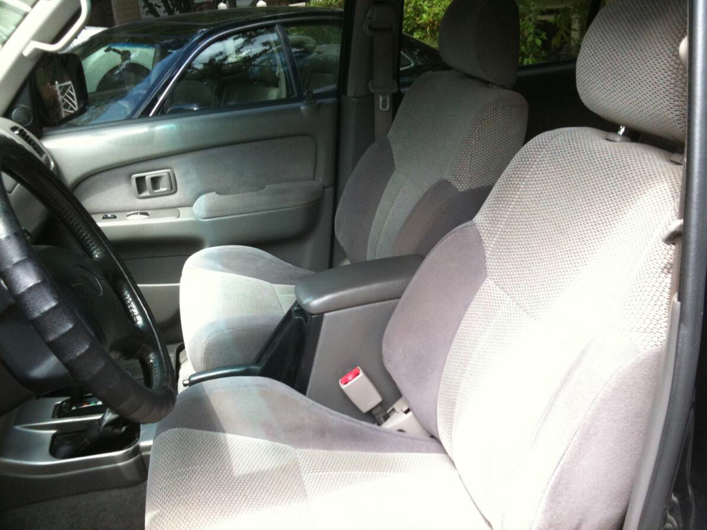

I thought the 01/02 sports had two tone seats as well like this but it appears yours doesn't
Edit.
On second look it does.
