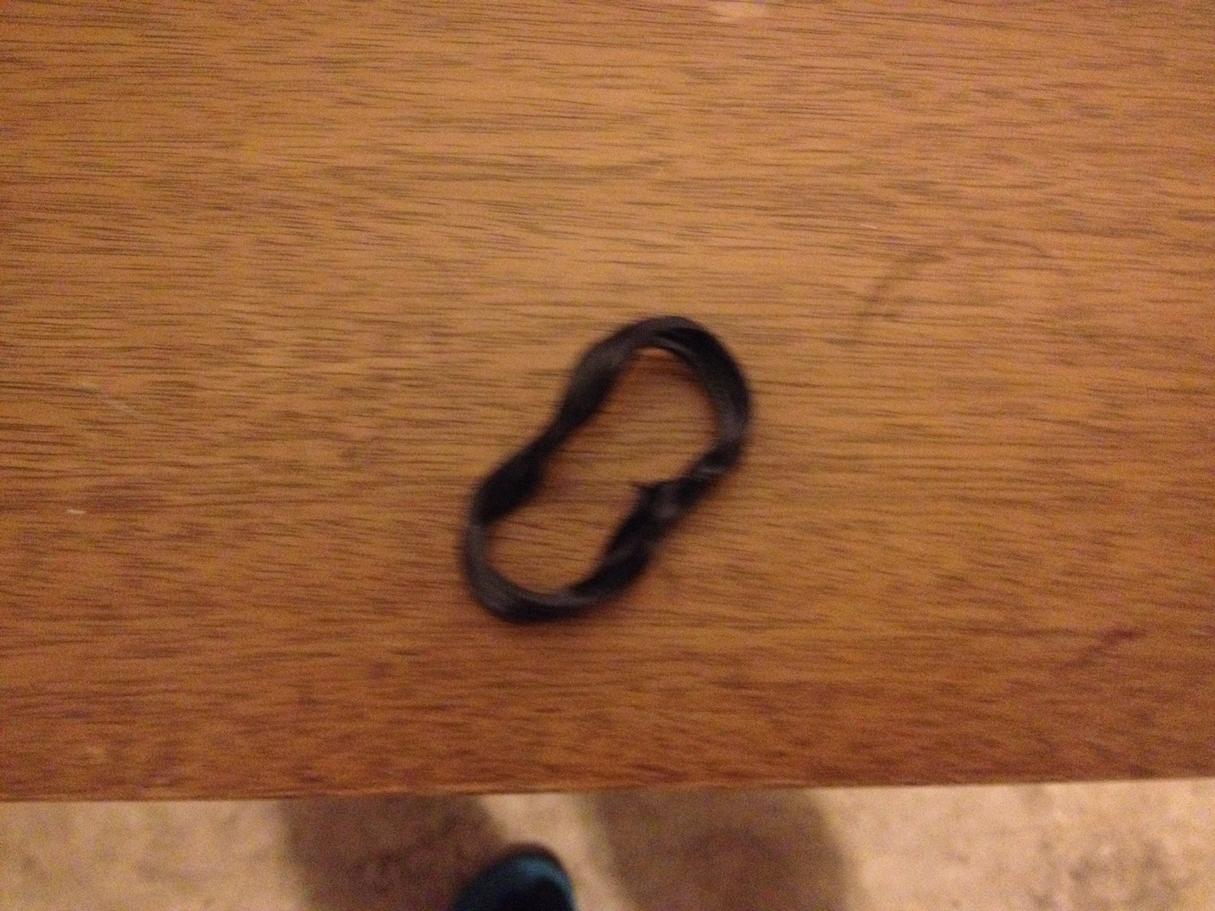

Is there any chance you may have used the wrong fluid at some point? When was the last time the vehicle had the brake fluid changed prior to this? Can you post a picture of the old master cylinder and the seals?

Would be interested in the pictures, my old one failed at one of the o-rings in the master cylinder piston.

ZPC solved the lights issue. The reservoir pics for reference posted here
