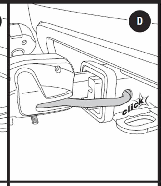

I just bought the Thule Apex 4 and it's got a new locking mechanism that requires a curved rod to seat into the hole on the hitch.
The problem is that the light duty hitch has two brackets that block access of the curved rod into the hole on the hitch.
Has anyone had this problem and have you bought a hitch receiver extender to insert into the hitch? I am looking for a short receiver extender.

My other option is to grind off that flat bracket, or at least a portion of it, to allow the rod to clear.

Yes, the Thule has the same feature which pulls back a bar that slides at an angle that causes it to increase in size. I just tried to fit it into my 2" hitch receiver and it was really snug even before I turned the knob. It seems as though the extender will be the weakest link in terms of rattle, so I may have to resort to cutting off the flange if there is too much slop in the extension.

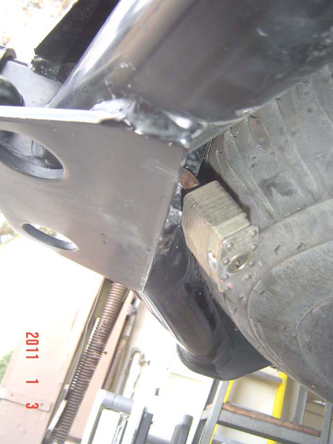

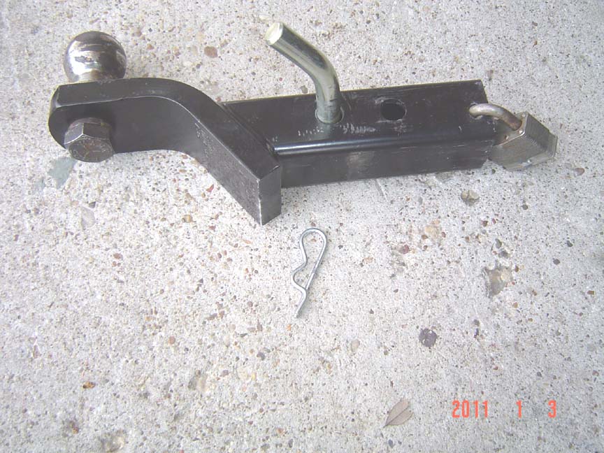

With my hitch in 07’s receiver restricts my garage and workbench (any T4R above 09 is totally out). My previous 1993 Ford Explorer of 15 yrs and etc before gave all the inches I needed with the tow ball mounted on the bumper). My solution to try and leave the hitch in was drill a new hole in the hitch with it as deep as it would fit. The 2” gained w/n enough for comfort at the workbench. I was able to add a 2nd lock on the hitch (attached). I also feel it helps turning my boat around in my small backyard.
I feel adding a new hole and moving out 1” could solve some problems w/o a strength issue. jow
