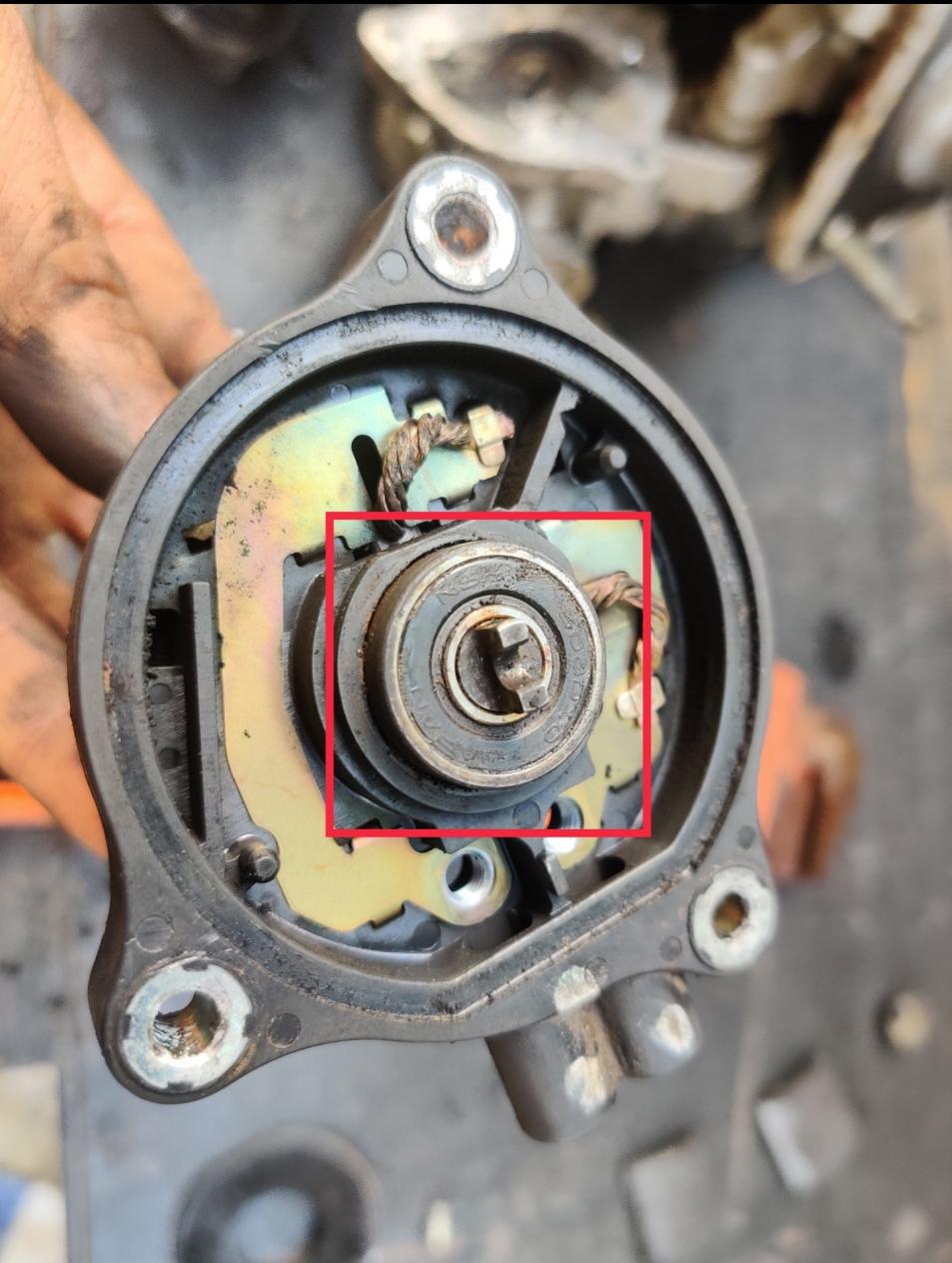

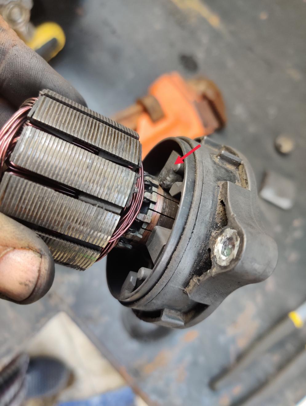

The ebay unit i installed about 5 yrs ago has failed yet again. I isolated the problem to be a bad pump and possibly leaking piston. The pump doesnt come on.
I have removed the pump and confirmed that one of the carbon brushes have worn down, and stopped making contact.
I am unable to remove the motor bearing as circled in the pictures below.
2ndly my motor appears to be slightly different from yours. Could you confirm how you were able to remove and reinstall the pump coil?
Unfortunately I don't think [MENTION=139329]Hawaiian Hillbilly[/MENTION] will respond, looking at his profile he hasn't been back on the forum since 11-30-2018.
