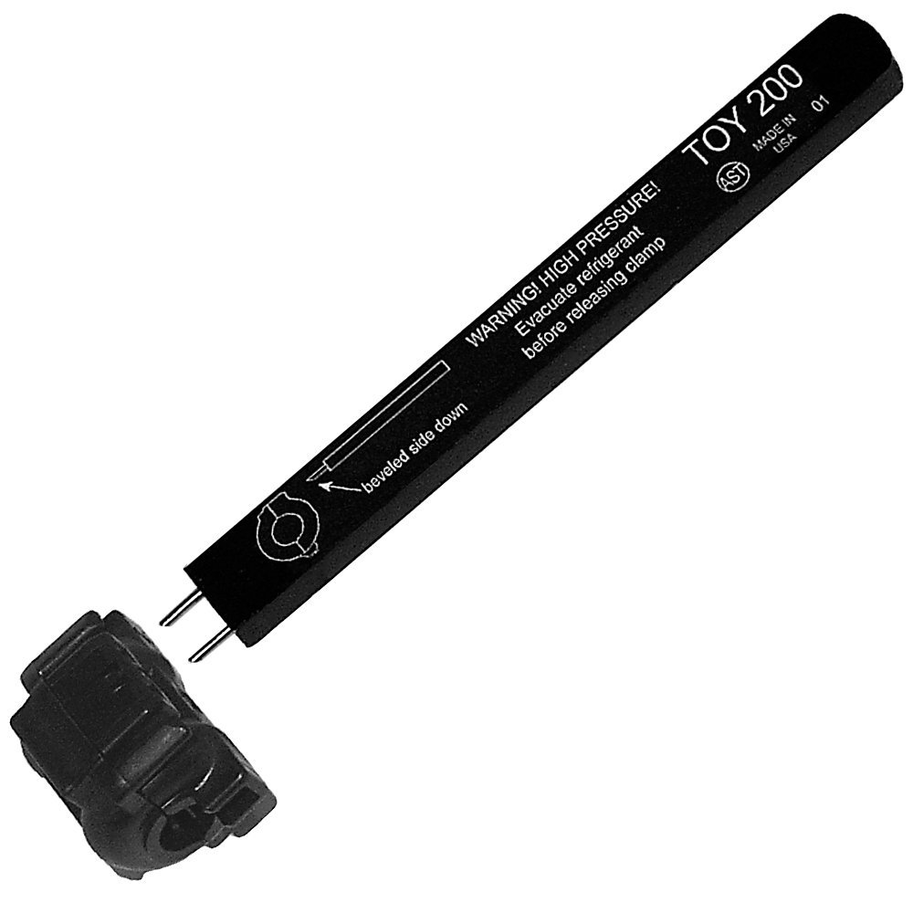

Still curious about the clamp tool though, or an alternative. I found this on Amazon.
