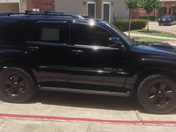

I'm considering driving to a bordering city to inspect/purchase a 2007 T4R that appears to be a heavily customized Sport Edition, but I'm concerned that the owner replaced the SR5 badging with the Sport Edition badging and is trying to be deceptive. I'm trying to understand if this vehicle could actually be a Sport Edition, or if it's just an SR5 in disguise. The current owner is a very poor communicator, so I had a hard time getting this info from him.
Here is why I suspect foul play:

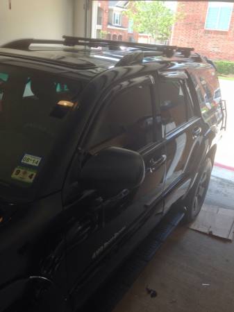

-1- The roof racks and running boards are NOT tubular, as is the (typical/expected) style for the Sport Edition. I'm unsure if the alternative roof rack / running boards were options upon initial purchase.

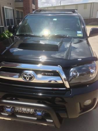

-2- The hood scoop is custom (and ridiculously large), so this isn't a distinguishing factor to tell if it's a true SR5 or Sport Edition
-3- The owner mentioned that it has a removable 3rd rear seat option (and I thought this was only available on SR5 and Limited trims)
-4- If you look closely at the "Sport Edition 4WD" badging on the side of the car, the "Sport Edition" seems to be exceptionally far away from the "4WD" badging...in fact, the spacing seems to be similar to that of the "SR5" and "4WD" spacing.

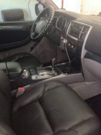

I've attached some pics to help in the identification of the vehicle's trim. Not sure if this helps, or not, but the interior is all black leather.

Also, as a side question, I noticed that "TRD" appears in the grill...does anyone know what TRD option might be installed on this vehicle?

Looks like an SR5 to me, it really doesn't have anything Sport besides the badge which like you said is spaced incorrectly. It's a poorly disguised SR5.
The TRD badge is a $13 ebay special. There is no TRD in that 4Runner.

Not a Sport. Looks like the mirrors are black plastic. On the Sport they would be painted black to match. Plus the inconsistencies you pointed out.

That is not a Sport Edition based on those pictures, the hood is a dead give away. The true Sport Edition hood actually smoothly transitions into the hood and looks "melted" in. That hood scoop is too wide and looks like a Cobra tack-on for a Mustang or something.
There was no TRD trim for the 4Runner, those badges pop up on a lot of Tacomas also. I think it was either a dealer thing or owner purchased item.
The Sport Editions only came with one style 17" rim and that is not it, those are typically seen on SR5 and some Limiteds. As far as I have seen all Sport Editions had silver roof racks, while SR5s seemed to have Black as an option. I don't recall ever seeing a chrome grill on a Sport Edition either. I can't see too well, but there doesn't seem to be any steering wheel controls on the vehicle, SR5's were the only ones that didn't come with at the very least volume controls.
