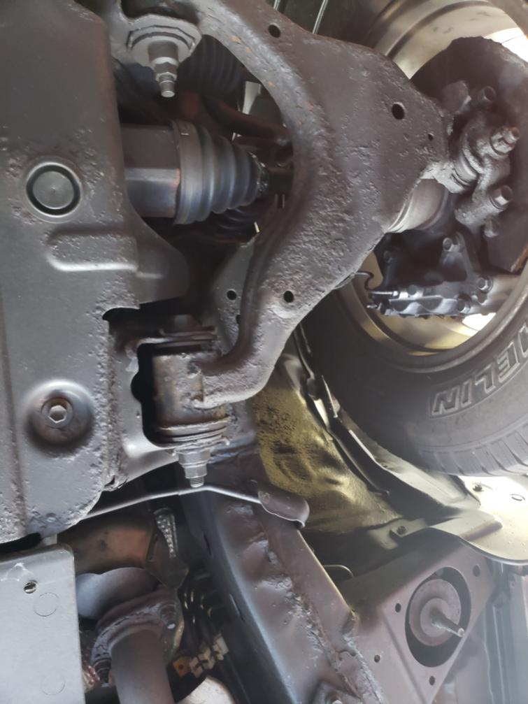

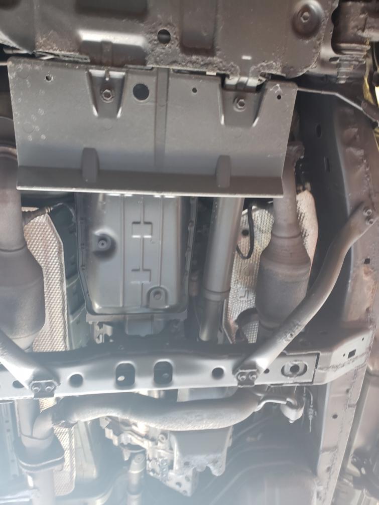

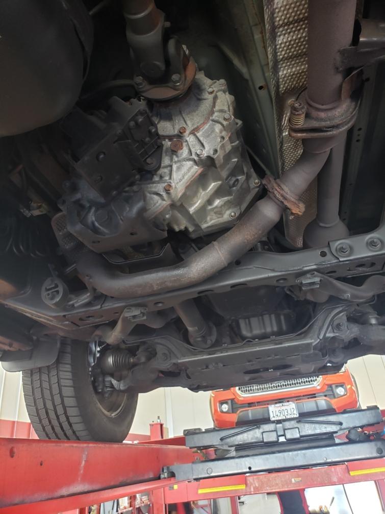

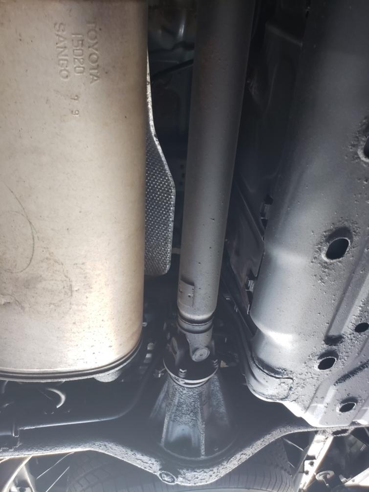

I am strongly looking to buy a 2008 V8 with 80k miles. Carfax is clean, one owner. Even though the car is in CA, it appears it was picked up via auction from Massachusetts. I asked the rep to send pics of the underside and this is what he sends over. What do you guys think? Clearly coated, but this is my first 4runner so I am trying to ask every question in the book (without knowing a WHOLE lot). It’s basically this and cigarette smell according to the dealer that have me hesitating. Hopefully I can use both to negotiate a tad.

Boroscope it or walk. Outside has clear surface rust that’s been spray painted as you already mentioned but no telling what the inside of the frame is doing.
Check the front auxiliary crossmember where the front skid mounts, that rots pretty damn quick/often. Check the section of frame near the front cab mounts. Check the area near the rear lower arms (rots out) and also check the rear crossmember.
By check I mean whack it with a hammer to see if you get a nice ting or hollow thud, and screwdriver poke it if it’s suspect.
Otherwise hard pass on a rust belt vehicle seeing as your in Cali. You should be able to find a better rust free option where you are at.
Literally the first thing that popped into my head is it looked like it was painted and they are trying to hide rust. That rear diff housing and many other places are pretty telling.
I’m not really a desperate buyer when it comes to even a V8 4Runner. I would pass if you can’t do a thorough inspection, and pick it up at the right price on top of that.

Thanks for the input guys. I actually thought it looked pretty good aside from some surface rust, so that goes to show my little experience and low mechanical knowledge.

Pass on it since you’re not in a rush. Look at the rusted bolts on the transfer case- every repair and mod will be a battle with seized bolts/broken bolts as you try to remove parts.
Hold off for a 4Runner that didn’t spend any time in the northeast and other rust belt areas. Unless you enjoy spending quality time with a torch and busting your knuckles when removing bolts! You’ll also pay more for repairs if you don’t do the work since it’ll take much longer for a shop to work on it.
Don’t trust a Toyota dealer any more than a random used car dealer, unless you’ve taken your trucks there a lot in the past with good experiences.

Its from MA so I would walk away. I got mine from there in 2011 and it looked pretty good, but it I am now having to patch the frame. It doesn't help I live in MN, but I have taken care of it the best I can. It is rusting from the inside out and MA uses a ton of salt. If your in a hurry, get a junker and buy some time until you can get the right one.
