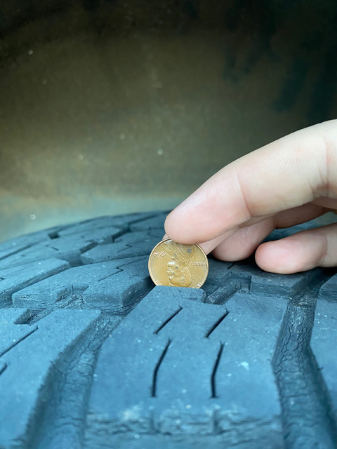

My tires (Nitto Terra Grapplers) have almost 45k miles on them but look like this:
