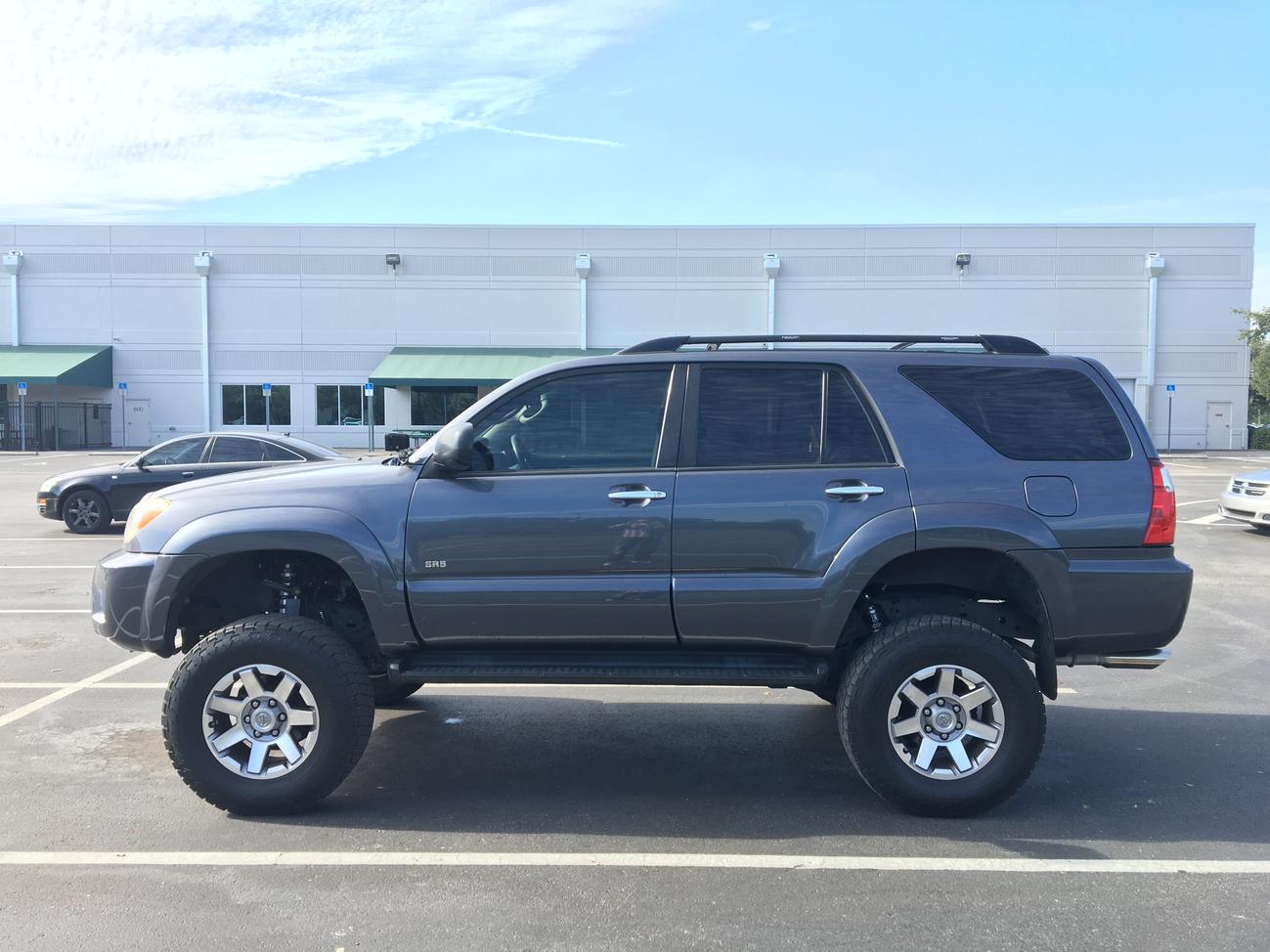

Good to hear she is still running strong. Just passed 150k myself yesterday.
