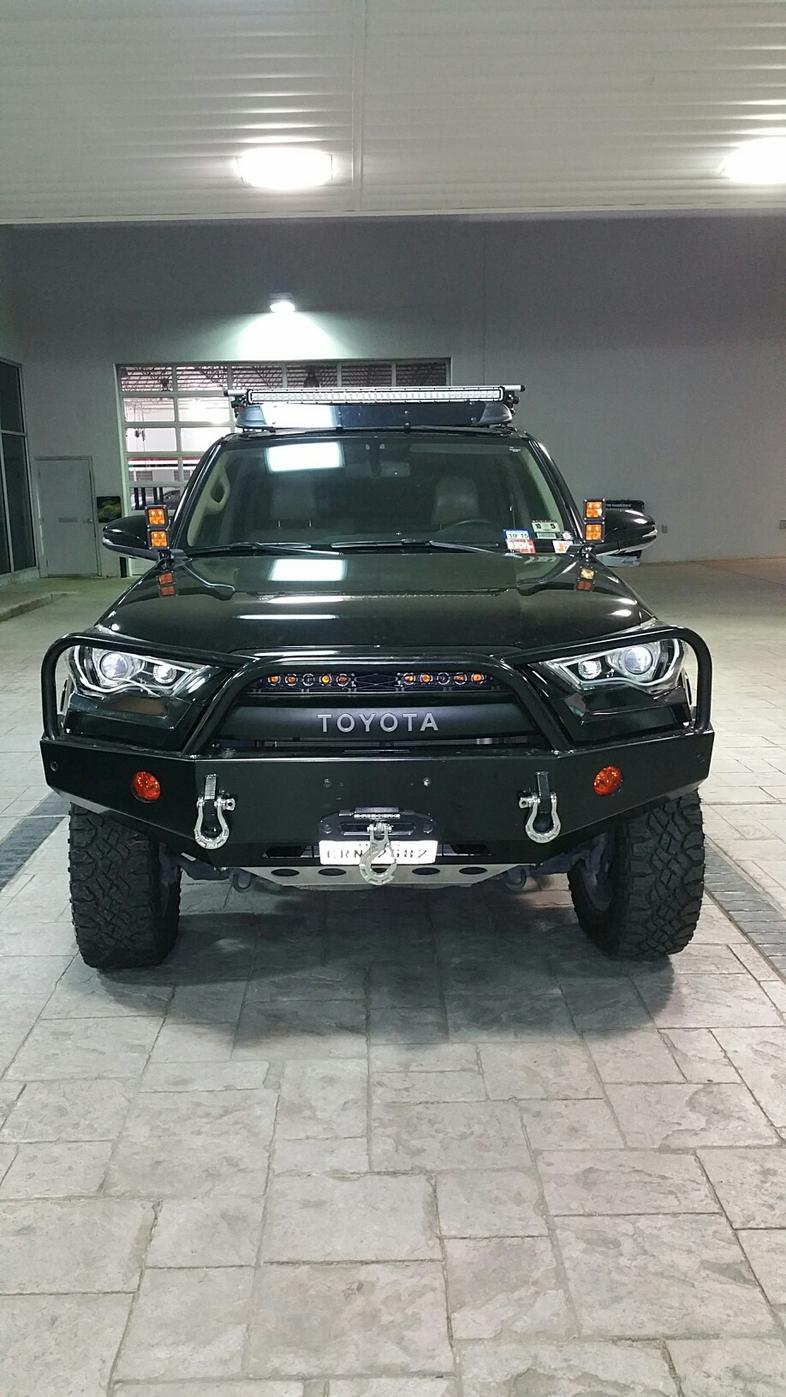

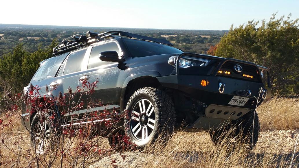

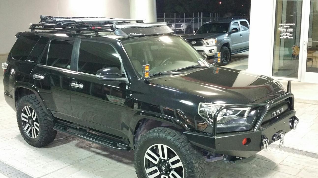

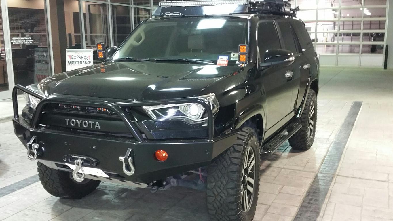

Body shop estimate came out to be $954.33, that's more than expected so I'm fairly certain at this point it will go towards fixing the truck with a Shrockworks once it all gets figured out.
