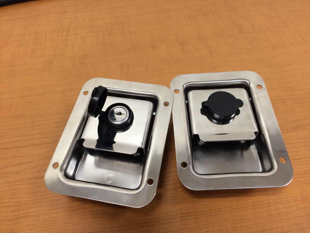

I am far from a carpenter and usually shy away from projects that require square edges but I wanted to give this a go. I chose to go with 3/4" Spruce plywood (I wanted to use Maple but it was double the cost) In total I will use about 2.5 sheets. I ordered some 24" full extension drawer slides from Amazon that have a 100lb capacity. I am still trying to find the right locking latches locally but may have to order them online.

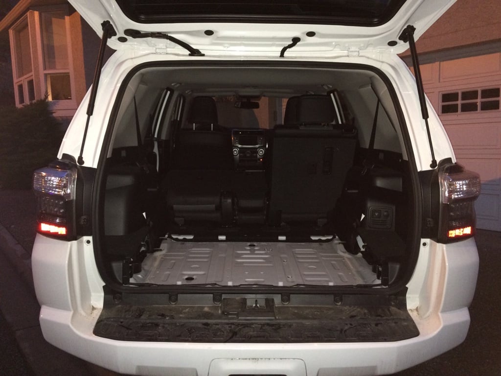

I started by removing the 3rd row. It took about 45min and unfortunately I didn't document that part. Its fairly easy though, all it requires is a 10mm and 15mm socket. I packed my rear seats up and put them in the crawl space for the future.

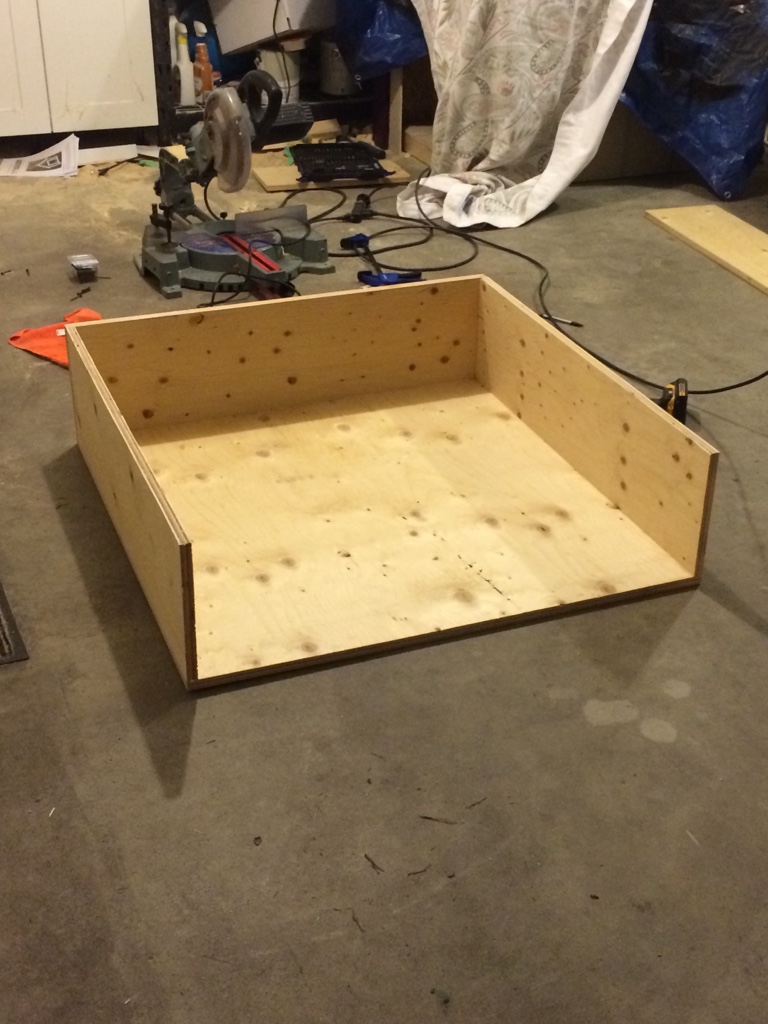

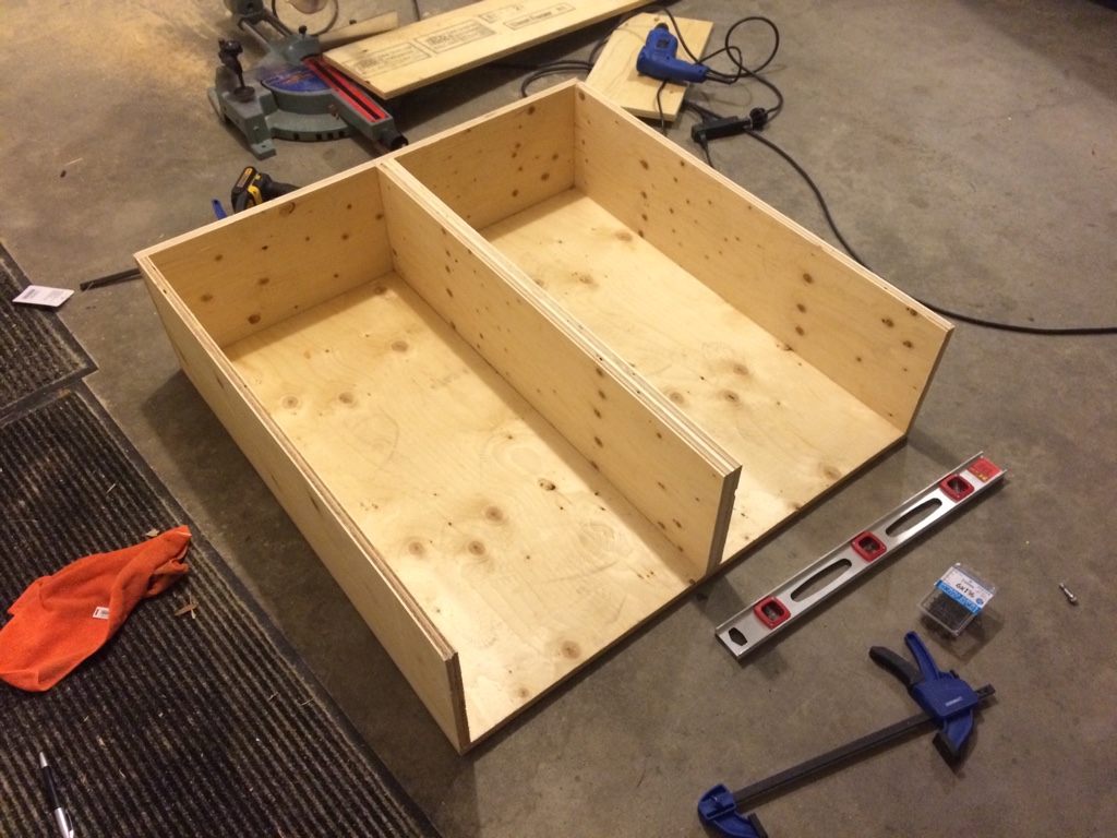

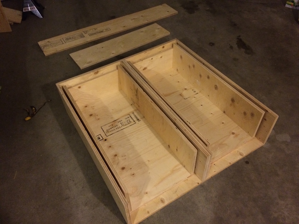

Next I started making the frame for the drawers. I am making it 38" by 38" and the sides have been cut to 10". I used 1"5/8 drywall screws countersunk to secure it all together. Each drawer will be about 17" wide and 36" deep.

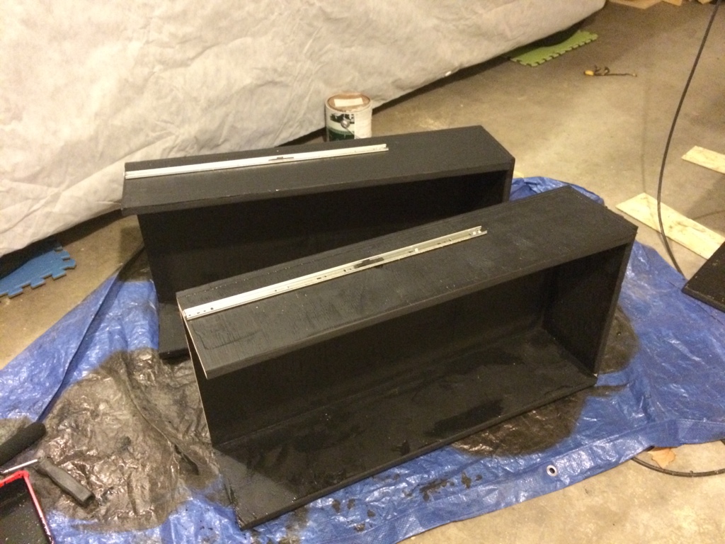

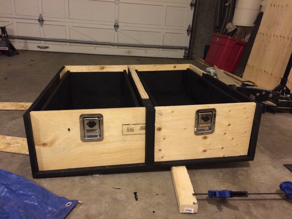

Built the drawers using the same 3/4 plywood and left 1/2" on each side to make room for the slides.

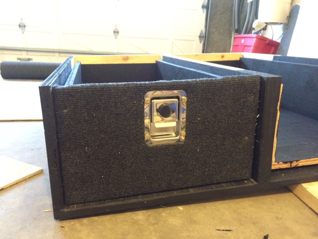

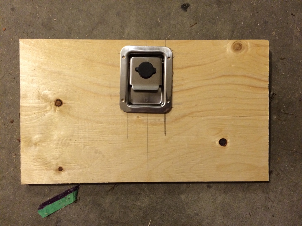

Made the drawer faces and cut in the holes for the latches. (Crooked in the pic but I will adjust.

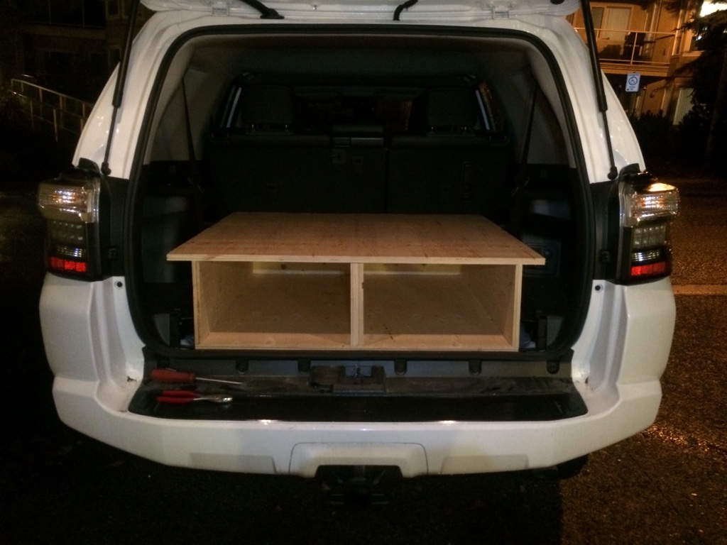

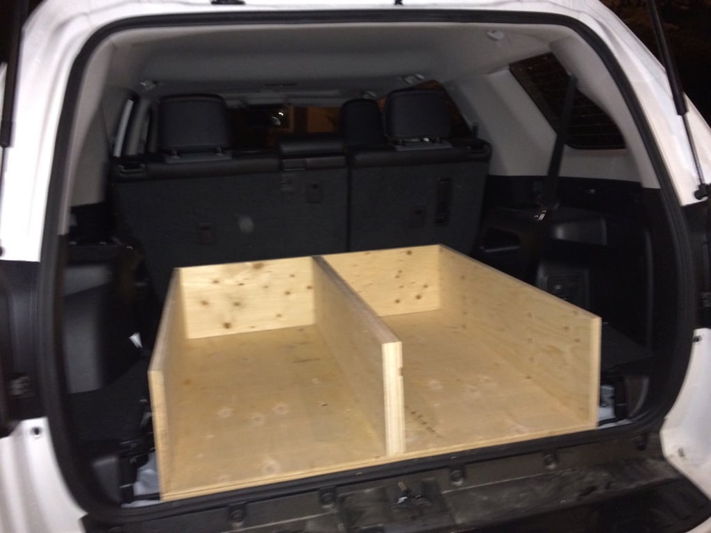

Next I finally did a test fit and I am very happy with it. It does sit a bit higher than I thought it would buy it's still okay by me. I will still retain the two small cubbies in each wheel arch.

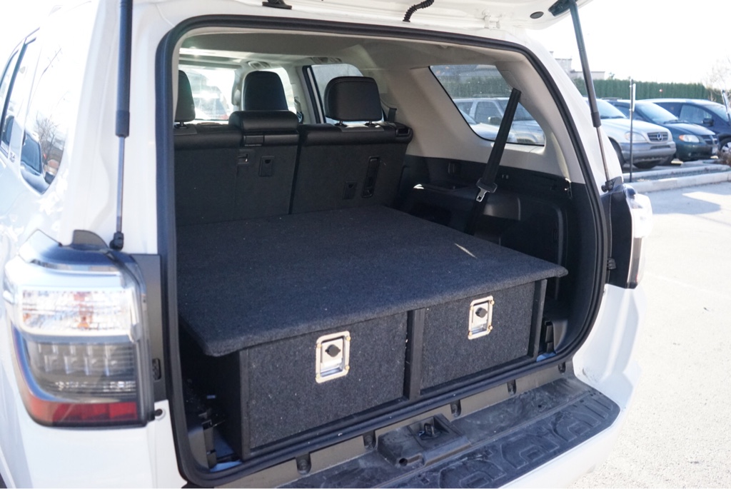

Finally got it finished today!

What are the overall dimensions of the area where you removed the 3rd row?
With the back seats in their furthest back position you have about 39" to the gate and it's about 42" wide to the wheel arches. Then you have those small little pockets on each side.
I am renting a router on Thursday to round all visible edges. After that I will get it all painted up, carpet the top, mount the drawers and a few other small things and I should be good to go!
