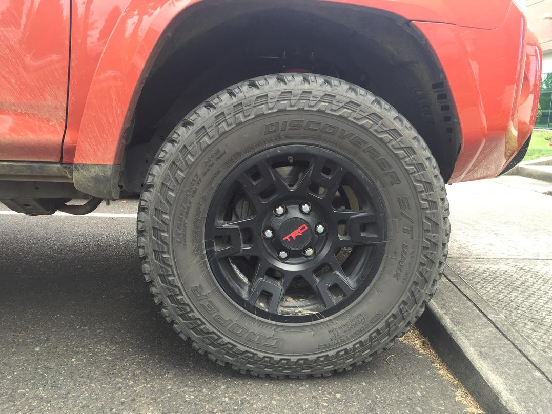

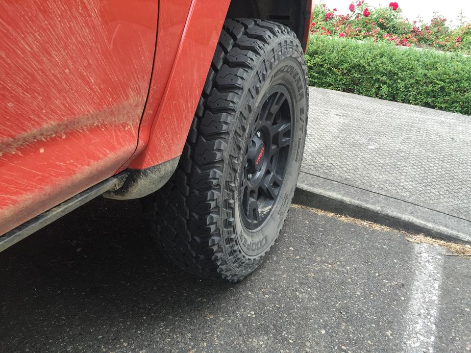

Hey guys.
255/80 S/T Maxx (Pizza Cutters) these fill up the wheel wells pretty well, however from a width standpoint, they may look narrow on the TRD pro wheel.
Here are a couple pictures of mine for your reference. I have the Toytec 2" lift so it should look similar to what you have planned. I have about 1k miles on these tires, lots of highway and maybe 75 miles off road, and I am very happy with them. I do have spidertrax 1.25" spacers and already had removed the front mudflaps, and have very slight rubbing at full lock in reverse, but only when under moderate compression. I recommend these 100% but good luck with whatever you choose!
