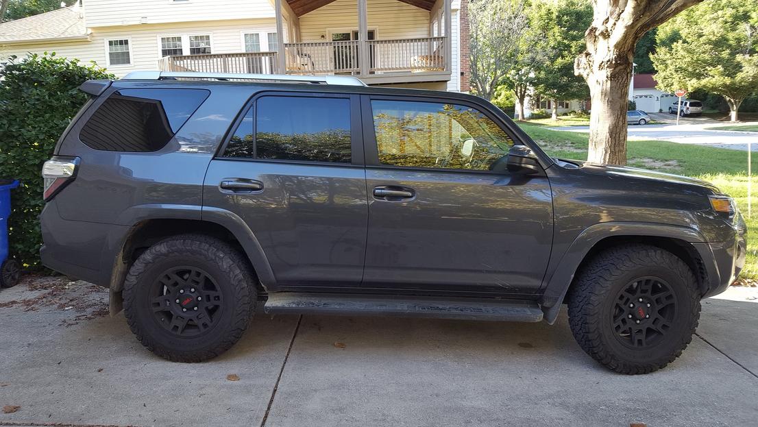

I ran that same setup but of course mine being a Pro it already had the fender liner mod done when it hit the port so I am not sure whether or not it would have rubbed without it. That said, there weren't any issues in any scenario and I tried to make it rub. I put a 1.5" spacer up front a week later strictly for looks and more clearance off-road.
275 KO2's stock with fender line mod.
275 KO2's with 1.5/1" spacer lift.
