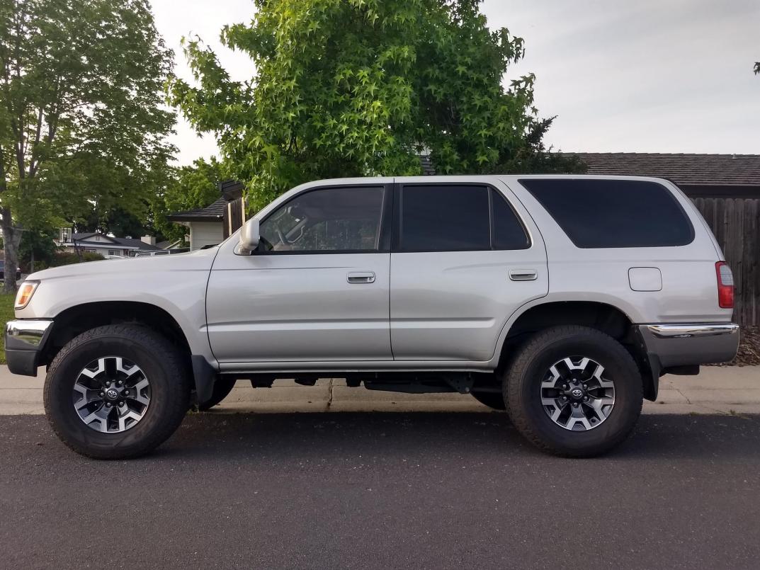

I added a set of Tacoma TRD wheels / tires to my son's 97 4Runner.... they fit well and look pretty awesome in my opinion. No rubbing while driving on the road (no off-roading yet), but I am not sure if it has stock / original suspension. We bought the 4Runner recently and it needed tires, so I went that route instead of just buying tires for the ugly original wheels.
