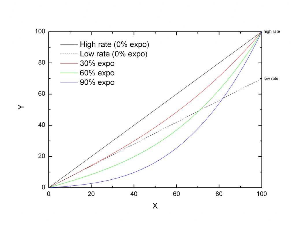

If any of you fly or drive R/C, then you know Toyota has added expo to our throttle control to help us...erm...drive more smoothly and save fuel. Pedal Commander allows you to dial in your own expo curve.
I'm curious to hear more about this and how it pertains to Sprint Booster and Pedal Commander.
This is a graph of how (negative) expo works on an R/C transmitter to lower the sensitivity at small inputs and still gives 100% at max.
The pedal commander would allow the user to alter the curve to make the pedal more sensitive in the first few inches of travel.
Higher end R/C transmitters have 5 or more points of adjustability instead of just 0 and 100%. This is practically a must to fly helis.
