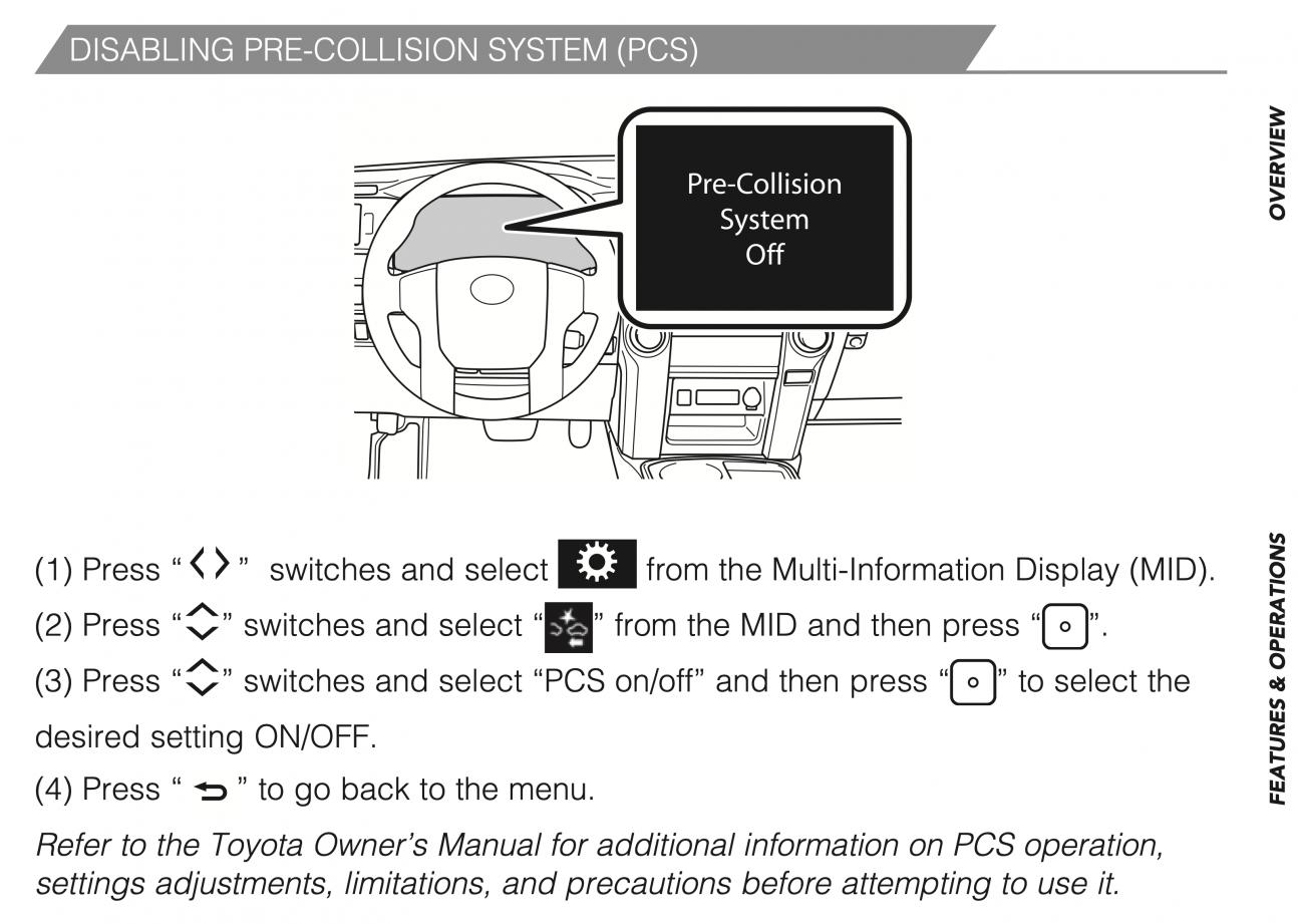

Go here to Toyota Owners site and download the Owners manual. It's all covered in section 4-5 starting on page 246.
It's simply a matter of going into the settings menu in the cluster display, choosing PCS (Pre-Collision System) and turning it off.
Please explain how to turn it off. I'm curious.
My understanding was that while you can disable the lane departure alert, you can't simply disable the collision system. I have had it disabled as part of turning traction control off (which you can do with a 3 second or so hold of the traction control button while stopped), but you can only adjust sensitivity of the system in regular rear wheel drive or 4 hi driving.
Even with traction control off, it will still detect that you may hit something. It just won't apply the brakes for you.
In the manual...
