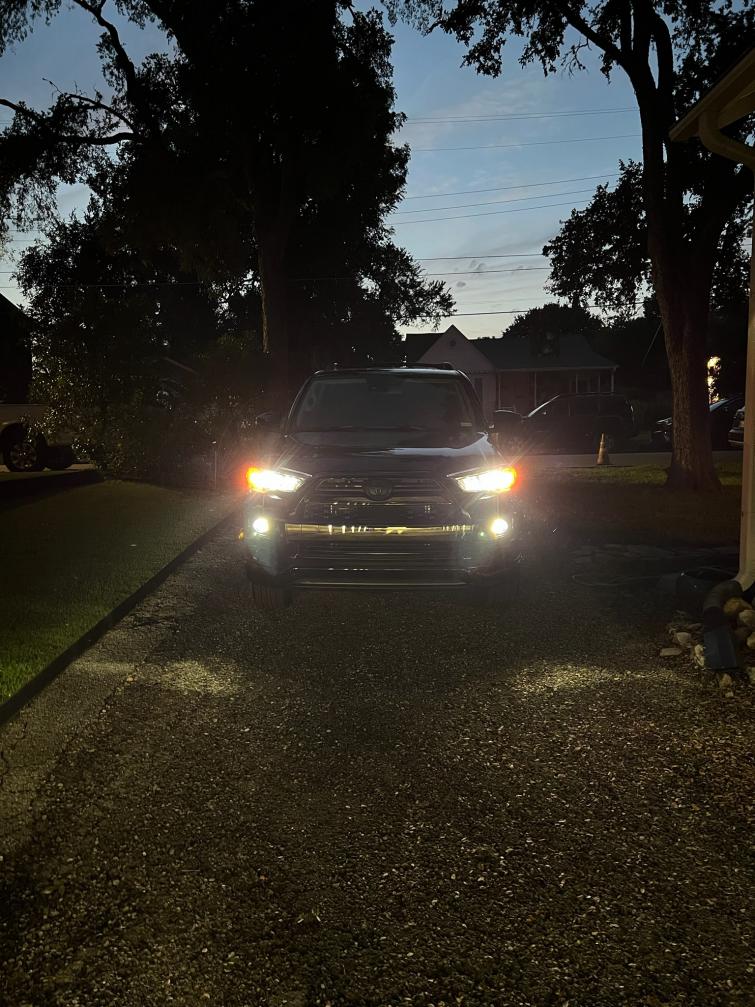

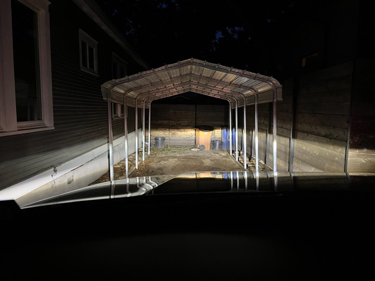

Finally swapped '20 headlights for the '21
Been following this thread for months and finally swapped my '20 headlights for the '21 on my Nightshade. Also replaced the fog lights with the OEM LED. As others have said it really was as easy as swapping the connection. Took a friend and I about an hour to do and I couldn't be happier.

Did this yesterday, got a set off marketplace for cheap, they aren’t perfect, but mine aren’t either. Took me about 5 min to swap the connectors and then another 45 to swap headlights. This blows away the XD HID’s I had in the halogen housings.
