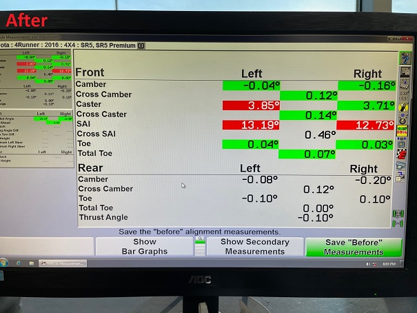

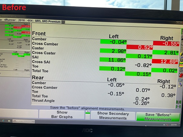

Purchased a 2021 4Runner SR5 about 4 months ago and have driven it ~3k miles. Overall, it was a huge step up in on-road comfort coming from a JKU wrangler and I like the vehicle, but there are a few aspects I'm not a fan of. Posting this in case anyone can relate so that we can suffer together :D
1) Wandering and loose steering in general
The vehicle seems to wander a lot and require constant input to the steering wheel. The steering wheel turning effort is also very low and even the slightest adjustment has a rather aggressive effect on where the vehicle is tracking. I feel like it will start to wander one direction, I correct the wheel, then it wanders the other direction, can never get it going straight, and feels sketchy to look down at the radio even for a split second in fear of going into another lane.
Checked alignment and as suspected caster was at the very low end of factory tolerance (near 2.75), camber on one side was a off, and toe in wasn't as even as I'd like. After correcting these numbers and getting caster near high end of factory tolerance of 3.75 deg, this wandering is MUCH better. It still has some sense of wandering and looseness in the wheel, but magnitudes better than before.
Open to suggestions on alignment to improve this further. Also, do I need to worry about SAI being out if caster/camber are good?

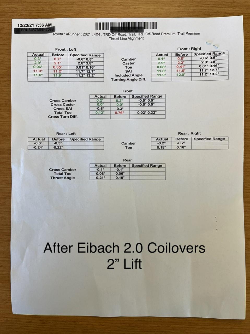

Reading your post, correct tire pressure for the tire you are running. Don’t overpressure a p rated tire, it will wander.
Your alignment seems off on the final.
See my specs after mine was lifted 2” in photo below.
It does not wander at all.
Gas pedal sensitive? REALLY, not on the last 2 T4R’s I had!!!!
Brake pedal sensitive? Not here.
Nose dive…. It’s a big suv with soft suspension
Want to rid yourself of the dive and body roll, change coilovers and front springs.

maybe you don't notice when you are driving you keep moving the steering wheel. a slight movement of the steering wheel makes it move quickly and that maybe different with your old suv. you might be in the stage of adjusting to it.
i've driven my 2020 4runner for 25000 miles, mostly long distance driving and it seems to drive okay when i drive it. when my wife is the driver during those times, i see her contantly moving the steering wheel and i feel it when she does.
moooooore castor. "in spec" doesnt mean its the best. it just means its a happy compromise for most people. touchy pedals are just things youll have to get used to IMO.

What's off on my final alignment spec? I shot for high caster based on forum suggestions in response to similar symptoms. Seems like it's a common post-lift effect where you can't achieve higher caster numbers without aftermarket UCAs and results in tracking straight poorly. Glad to hear your setup is working though! I'm likely going to try out the Bilstein 4600s and will have a chance to redo the alignment again. Will likely shoot for a tiny bit closer camber (-0.02 is factory nominal) and a bit more toe (like -0.06 each side).
I'm thinking that the looser steering wheel feel and factory dunlop tires account for the remainder of my "more wandering compared to other vehicles". I would say on smooth asphalt the 4runner is pretty comparable post-alignment, but on grooved concrete the wandering is worse, which points to tires.
