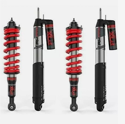

As the title says - has anyone done this yet - swap for 5th Gen TRD Pro FOX Shocks in their 4th Gen? Thoughts?
Is it as simple as other 5th Gen swaps; ie. increase rear shock top plate diameter and decrease bottom shock bushing size?
My thought is you are correct. I think its a high quality strut/ shock. I would guess it would give you probably about a 2 inch lift up front and maybe an inch in the rear. If you want to lift beyond that, you would need specialized spring
Thanks, that is what I was thinking - that little post on the top of the rear shocks would hopefully fit in the pre-existing hole that is used for the shock top currently but not 100% sure.
