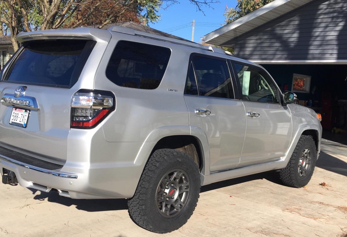

Are you going to remove the XREAS so you can lift/level? If you keep XREAS you need to use spacers. It may be possible to level/lift with springs on XREAS but those lines make it nearly impossible. 2/1 cornfed spacers and 275/55/20 all terrain KOs is my vote. Here's a pick of my stock xreas and springs with TRD rims and KO2s 265/70/17. I enjoy the xreas on the street. Im also a fan of duratracs

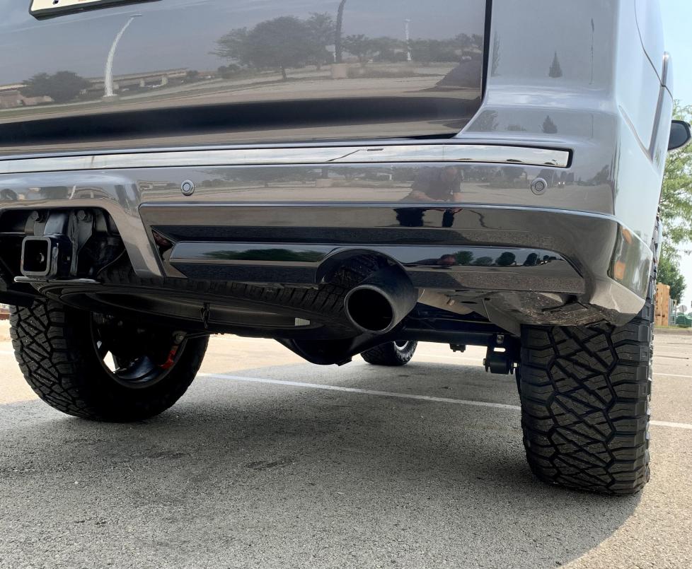

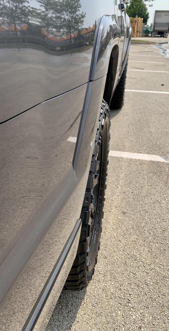

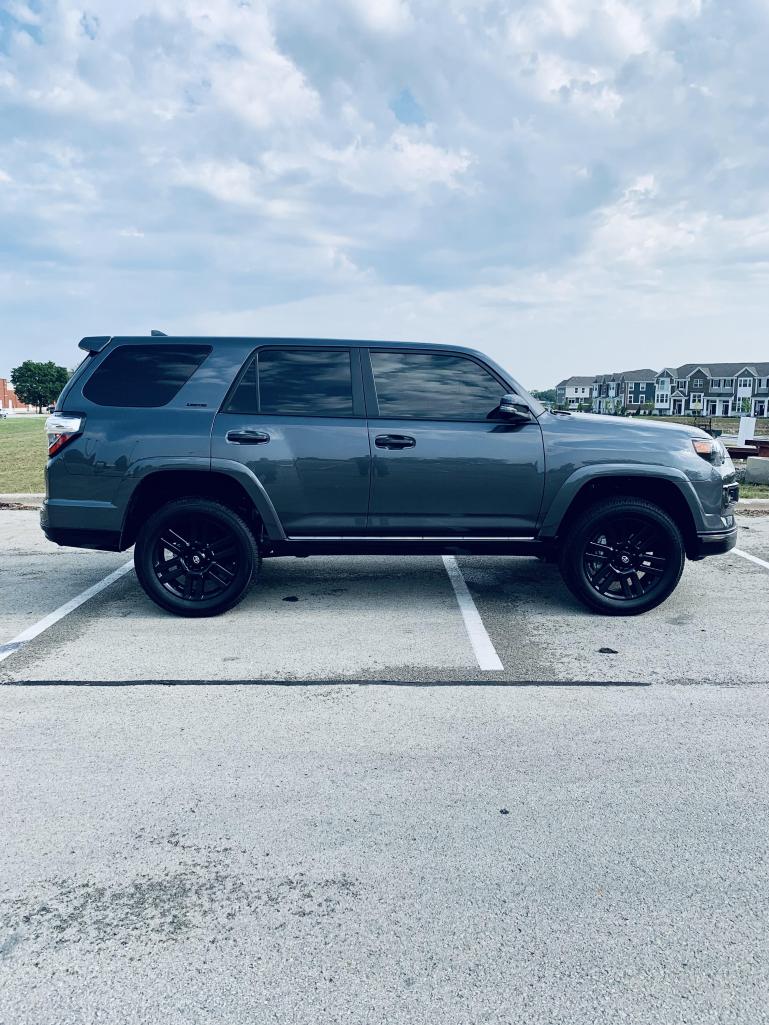

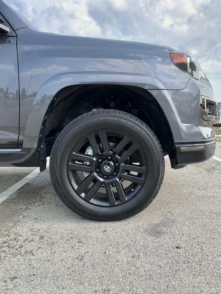

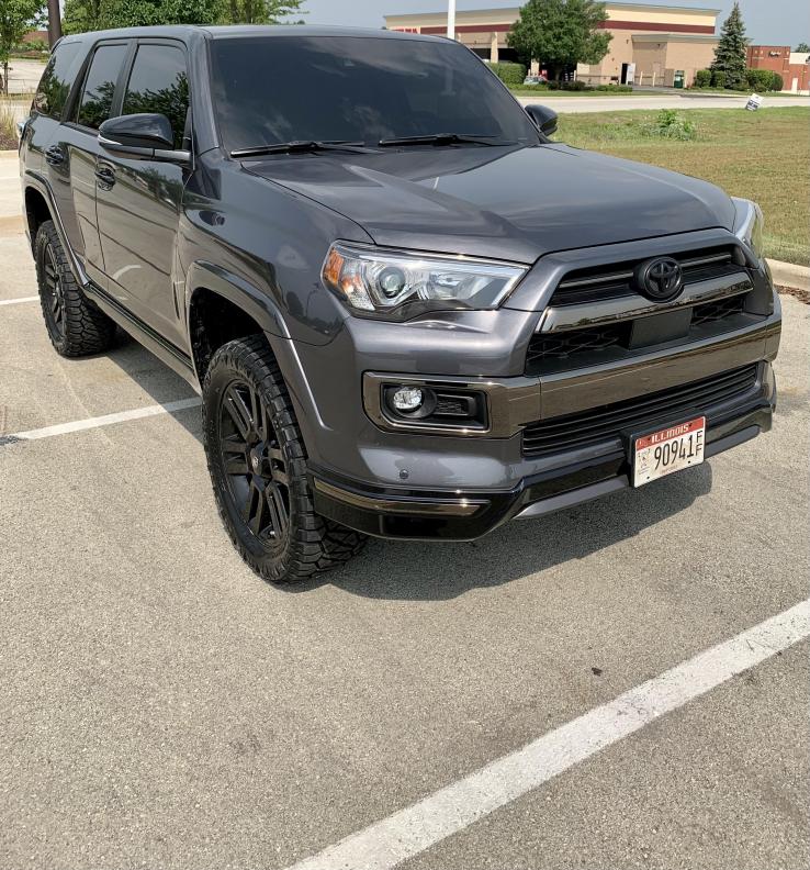

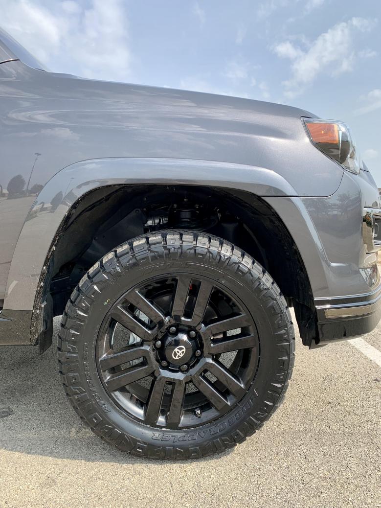

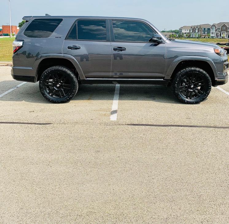

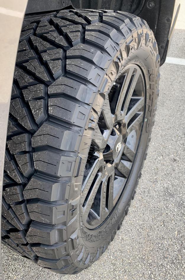

Update 7/28/21
Finally got around to doing some stuff to my 2021 Nightshade.
Tinted the windows (including the front windshield), removed the factory roof rack, lift and larger tires.
Lift is a Cornfed 2/1 lift and tires are 275/55/20 Nitto Ridge Grapplers on the stock Nightshade wheels.
No rubbing. No issues what so ever. First two pics are of the stock tires with the lift, then with the Nitto's..
