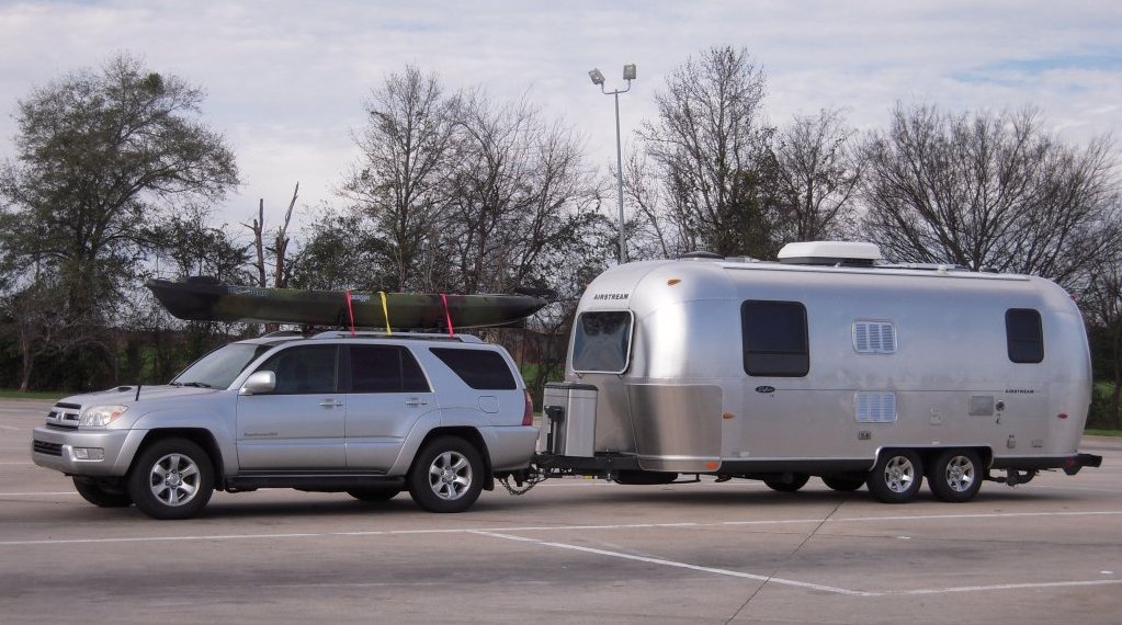

That T4R will tow 5,000 lbs. with 500 lb. weight on the hitch right out of the box. I'm sure it has plenty of clearance too, maybe more than the Airstream Basecamp. If there is a worry about sag that could be easily remedied with a weight distributing hitch. I use an Equalizer with my 23' and have no problems.
