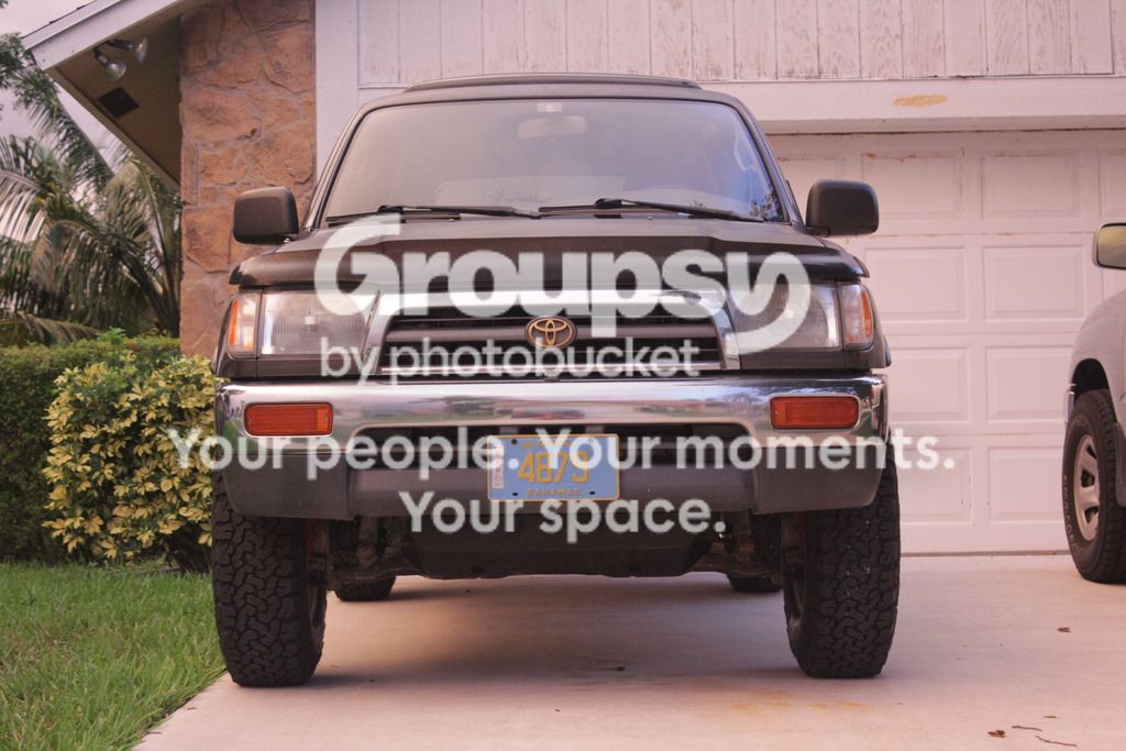

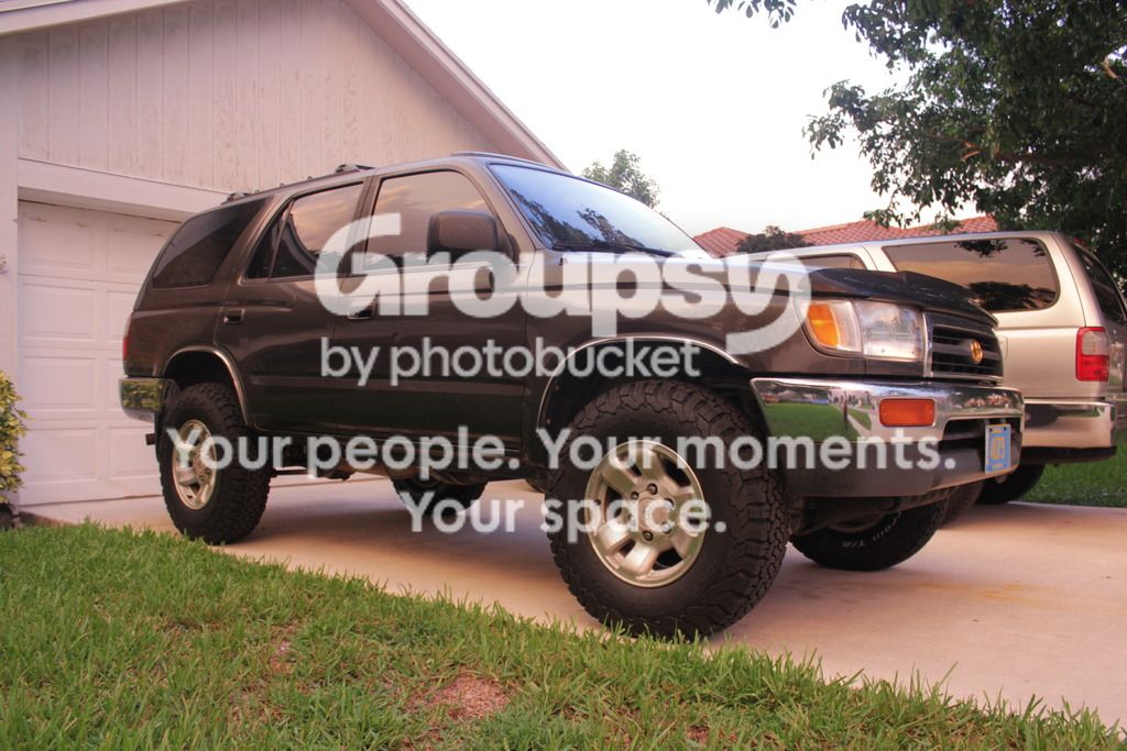

1996 4Runner SR5 4x4. BF Goodrich All-Terrain T/A KO2 235/85r16
They are a bit more aggressive looking than I was expecting, but I really like how they ride. The shop put them at 37psi which gave a soft ride, but felt reallt mushy and sluggish. I thought it was just from the 1" increased diameter. I pumped them up to 55psi and the truck really came back to life. I feel more bumps in the road though. What pressure do you guys run your 235/85s at?
The skinnier tires don't look bad at all to me. Can't wait to get them on some terrain that will test them!
Thanks for the help.

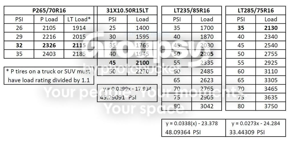

So... I started thinking about the inflation pressure and doing some research, and this is what I came up with.
Manufacturer Spec on a 1996 4Runner SR5 4x4 V6 requires 32PSI inflation on front and rear tires.
Stock size is P265/70r16
* P tires on a truck or SUV must have load rating divided by 1.1
I found the following general tables at:
http://toyotires-1524598101.netdna-...of_Load_Inflation_Tables_20150623_Final_0.pdf
P265/70R16 32psi 2115 LT lbs
LT235/85R16 50psi. 2205 LT lbs
LT285/75R16 35psi 2130 LT lbs
Comparison graph
Tire%20load%20comp-1_zpscs5dv7ux.jpg~original
[/URL]
The vertical line is the load rating of the OEM tire ant OEM pressure. Where this line meets the line for your tire tells you what the PSI should be.
Stock P265/70r16 tires at 32PSI have a load rating of 2326LBS. If the LT correction factor of 1.1 is applied, the rated load for our stock tires is 2115LBS. In order to obtain this load capacity with LT235/85r16s, the table shows inflation must be between 45PSI and 50PSI.If you do a linear curve fit to the LT235/85R16 tire, you get the equation:
PSI = 0.0338(LT Load) - 23.378
Insert 2115lbs for LT load and solve to get 48.1 PSI
I believe that the BF Goodrich employee I spoke to assumed that the stock tires are LT, not P. This is why he recommended 55psi.
Using the same method: a Load of 2115lbs on the following sizes
LT285/75R16 = 33.4 PSI
31X10.50R15LT = 45.3 PSI
Seems to be pretty logical, but use your best judgement! You would think the tire installer would know this stuff so they would inflate the tires correctly. According to this, my tires were 23% below the correct pressure when I left the shop!

Jcush87, Id love to see more pictures from the front and rear 3/4 views at normal standing height.
Ive got a rather large internal struggle going on between 235's and 265's lol. Not a lot of photos of 235's on 4runners kicking around :P
