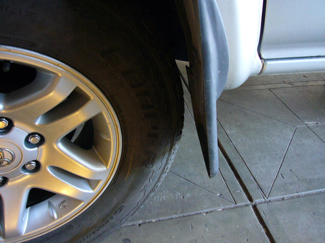

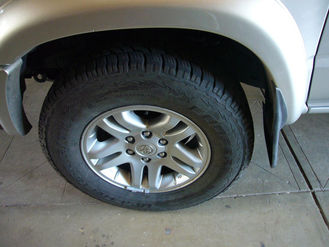

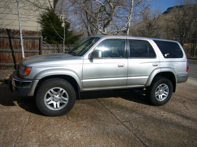

I have those same wheels on my 2001 with stock suspension and 265/70/17 Cooper ATW's. No clearance problems at all.
Thank you for the reply and I think the Cooper's are a off road tire so that size may be just what I need. Do you have any pics to share so I can see as well.
Again, thanks
Here you go. The back is a little high right now, I'm half way through a lift.
