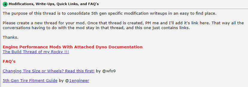

A front spacer will do more to affect the look of your ride than it will to affect what tires fit. I'd pick a tire/wheel combination and work backwards from there to see what may or may not fit. Better yet, search for anyone who is using the same combination and see what results they get.
Have a look at the top of this forum page, there is a lot of good info on tires, lifts and what fits.

I looked at that thread already "buddy" . There is no answer to my question( I read it again) .
The chat in the beginning doesn't answer my question either.
