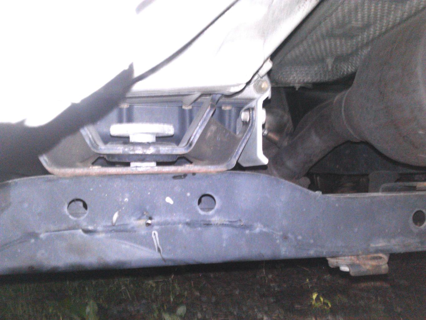

Also, I am posting a pic of my trans mount. Does it look loose, or is it just me? Could that cause my nasty vibration problem??? Or maybe bad gas making it miss? If it were gas, I would think it would do it more often...

Also, still wondering about the trans mount pic I posted. It just doesn't look right to me...
