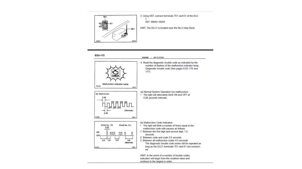

Failure codes
You can check it in the driveway by inserting a small wire in the diagnostic test port and check the code on your dash.
Once you have inserted the wire in the TE1 and E1 connectors turn the ignition key to on. If there is a failure code or codes the engine light will begin to flash. The codes will repeat so you can take your time to watch the sequence of flashes. It is pretty easy to pick up the sequence and the longer gap in time between codes.
