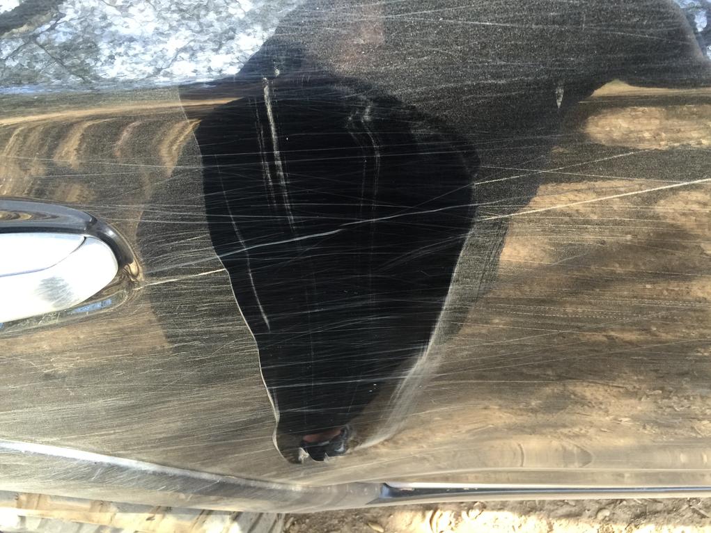

I mean if you can find a way of getting 35/12.50s to full stuff with the stock fender arches and not going long travel, I'm all ears. As it stood when I got them originally mounted, they worked fine on the steet in a straight line. If I hit a curb to hard when I was turning into s drive or parking lot while turning, it was tire vs body the whole time.
With the fender rolling I can do full stuff Offroad. If I were to opt for full 3.5" long travel I could potentially fit smaller 37s without much involved.
