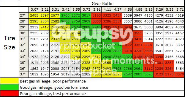

ETA: This might help you though, if you're dead set on it.
GearRatioChart1_zpsbbff7d13.jpg~original

War Sprout,
The only problem with that chart is the word "performance" should be replaced with "off road performance" because it certainly isn't 0-60 performance. The bigger the tires the more underpowered the truck feels. Pretty much the opposite of experiencing speed performance.
I disagree higher gear ratios make the truck perform better on and offroad. As long as the tire size is upgraded equally, 33s and 4.88 would give the best performance in stop and go traffic as well as the better low end torque in offroad applications.
I can vouch for this. I run 33 A/It's with 4.88's and my truck is a lot faster on road, and drives over everything.
