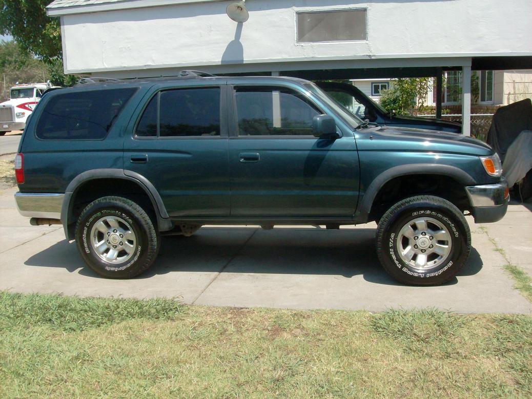

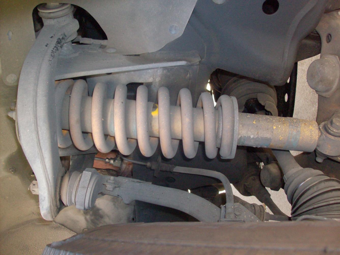

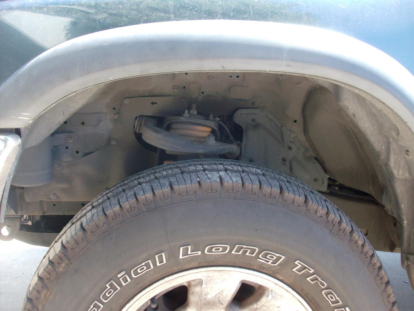

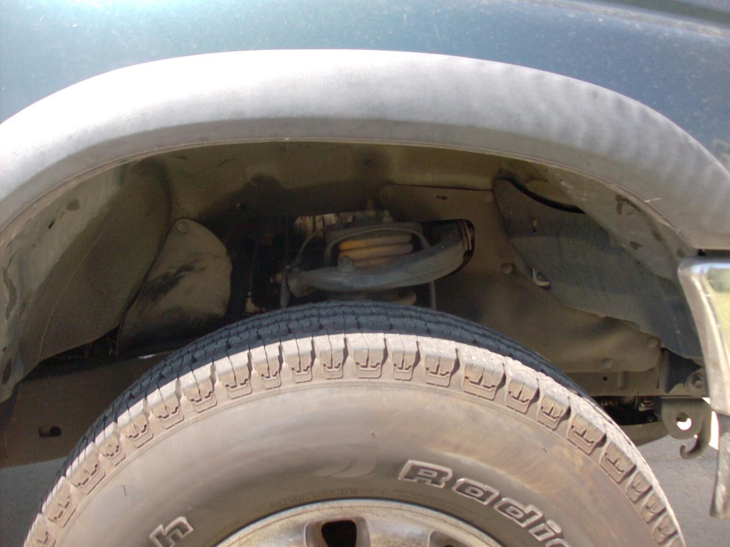

Still in major progress. Dont quite know how I can find out how much lift I have on my runner. I got it as a gift and wasn't too much into off-roading til maybe a year ago i've gotten deeper into it. No one else I know is into off-roading so I cant really ask them. I think they are Bilstein but not sure of brand or inches. Any help is appreciated. Thanx

I think it might have about 2 in. lift cause height measure about 69 from ground up to top of roof and stock is 67.5 i think but how can I be really sure so I can skip the shock and coil add on and proceed with B.L and tire size.
measure how high it is to the middle of the fenderwells. i can't remember what mine was stock, but i'm at 40" in the rear and about 39" in the front now. In that second picture, is it me, or does it look like that CV boot is already torn?
You Have Performance Products 1" lift springs. When I put them on my 98 I gained about 1.25 inches. So your probably at the same, maybe a little more. Those are definatley Bilstein shocks. Do you have the same springs in the rear?
