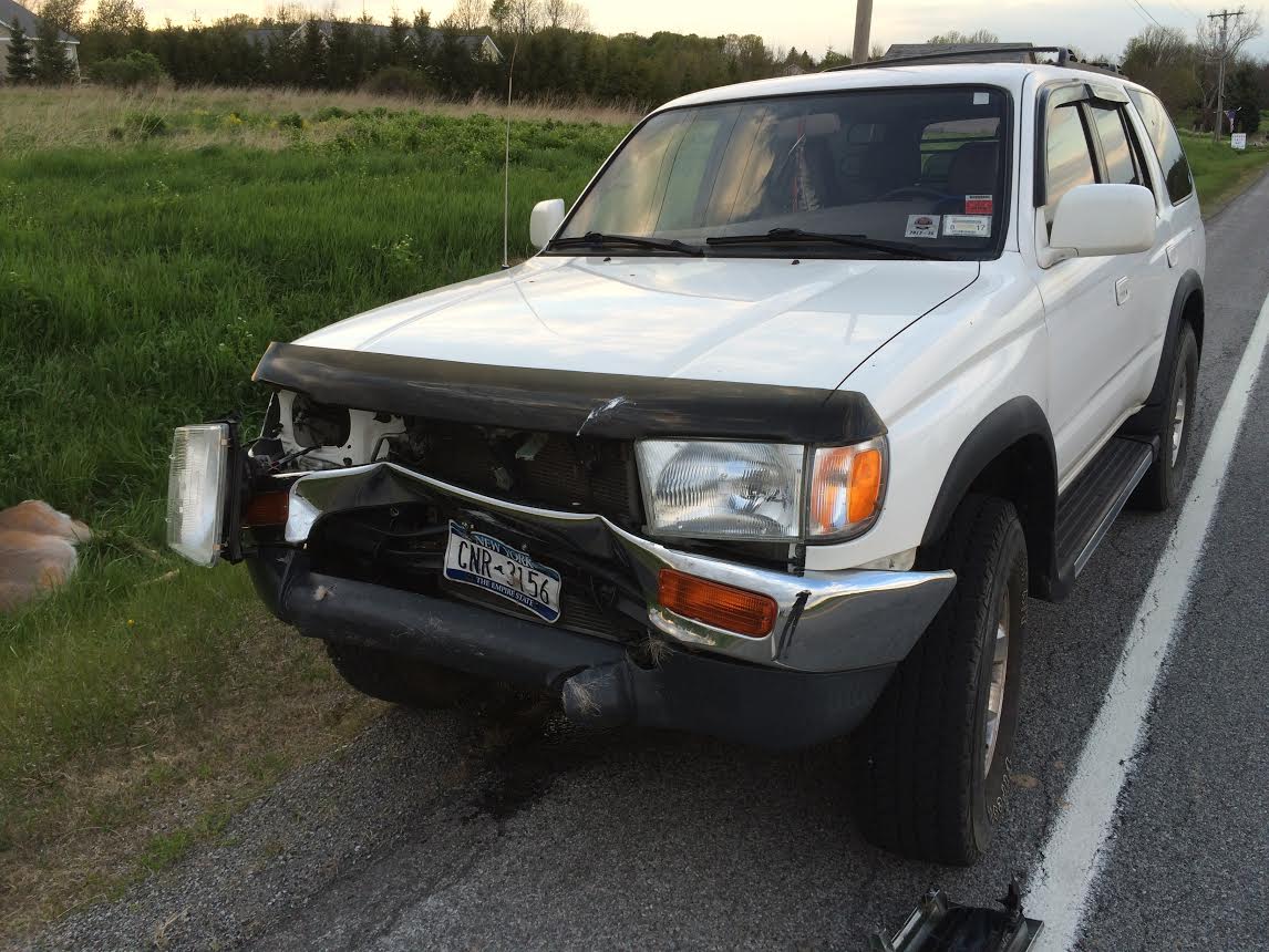

Here, have a pic of my post deer hit baby, lest you think I'm just a tire kicker. She looks a whole lot happier now. :bravo:
