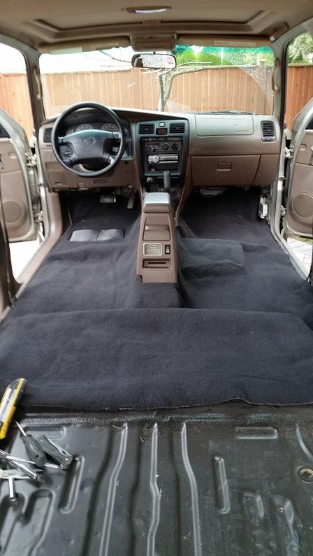

Here is the one I used, good quality and the best price I found. Get the mass backing:
Auto Carpet for Car, Truck, Van - Stock Interiors
I would buy from them again.

I just did this to my truck and I used a carpet from stockinteriors.com as well. Good fitment and good price. However it won't be a direct fit, lots of trimming needed.

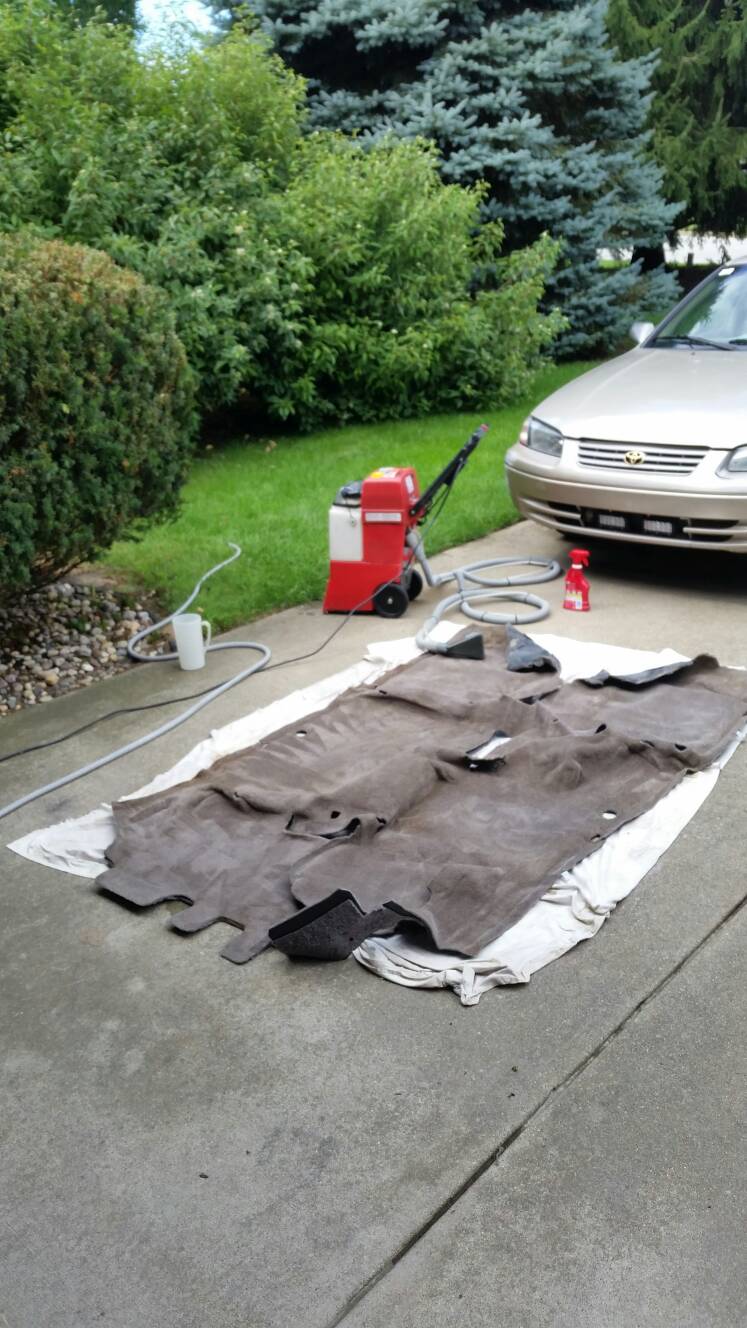

I just spent a couple hours using a power vac, resolve spray, and about 5gallons HOT water through a steam cleaner. Then drapped it over the hood of my camry to dry in the sun, it dries fast!! Then did the seats a lil bit, not bad for what its worth.
It was mainly just coffee.

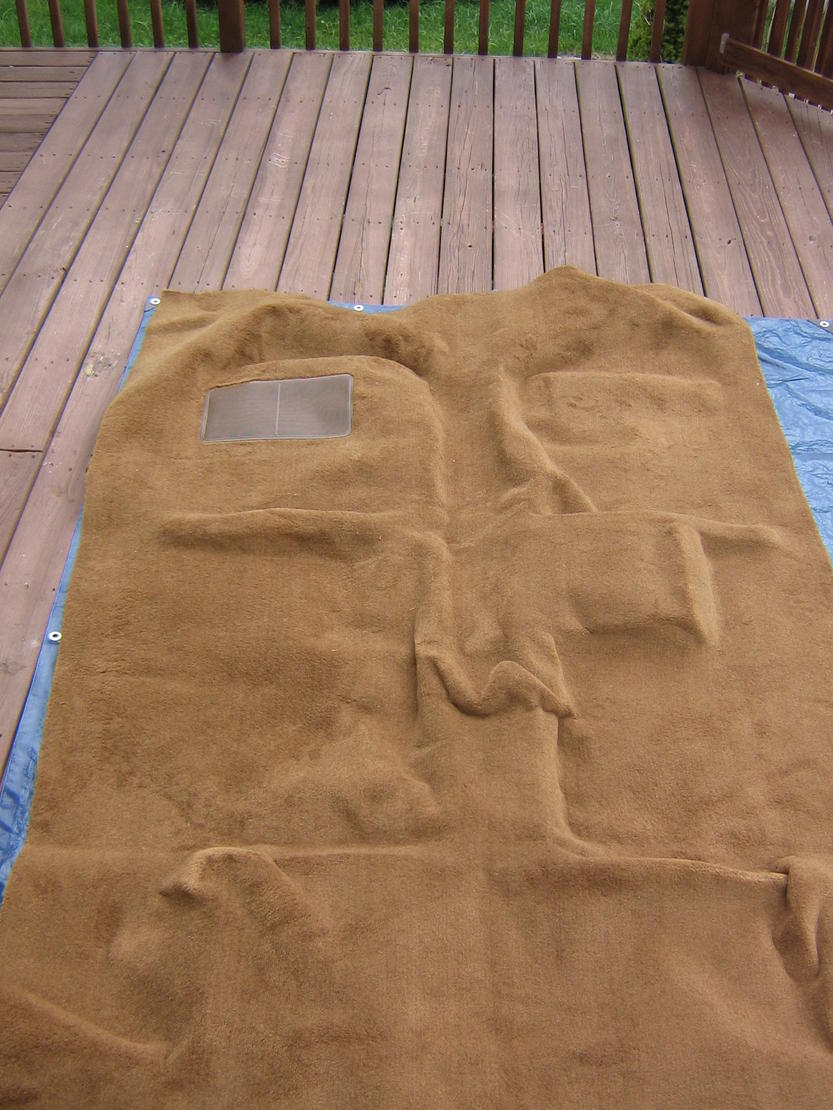

The stock interiors definitely has a hump for the heater, you just have to cut the intake hole.
I would think most of them would have it.

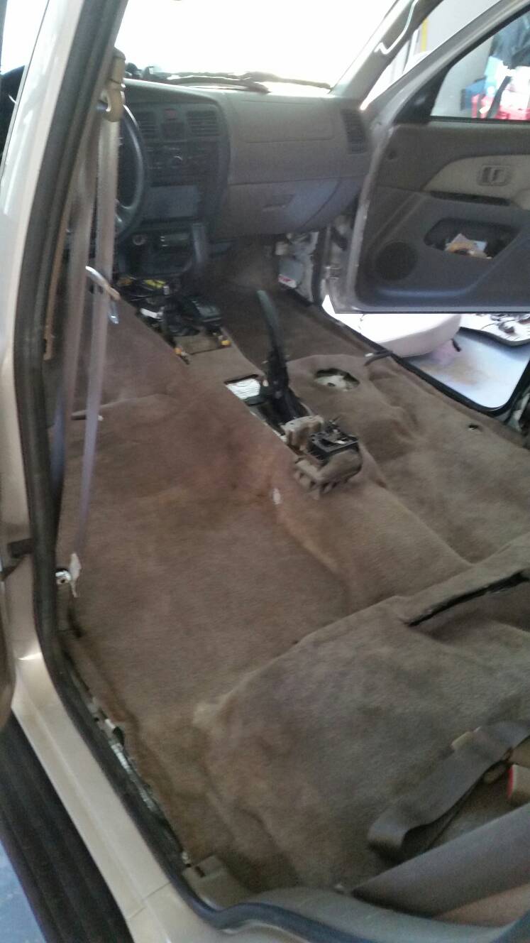

Which kit is that? The ones I saw had a defined hump for the rear heater, its visible in the photos posted above on this thread!
Sorry, I was going from memory. Mine had it, see pic. It was an option in the US not all had it. My Base model is fully loaded so I got lucky.
Fair play, it was done by region in japan, mine didn't have the "winter pack" so I don't have it. The space is more useful I think, and here in the UK most have corrosion issues with the lines!
That said I'd like a new carpet, and don't want a saggy hump bit where the heater isn't!
