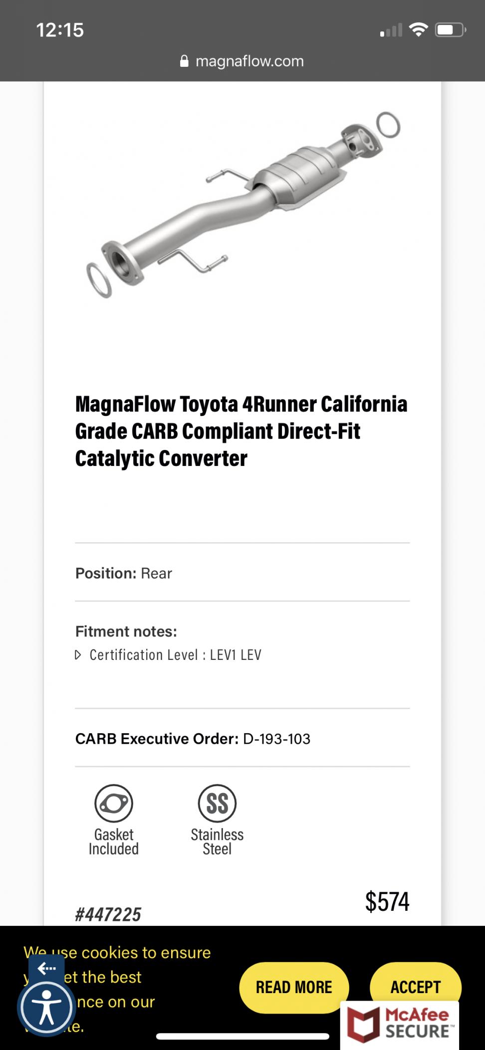

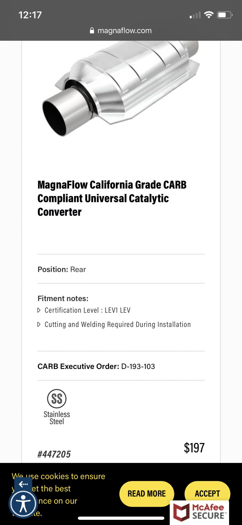

Hey 4runner fam! Still having the same annoying issue with my 3rd gen 4runner. I’m located in California and it won’t pass smog for its life. Truck has 280k miles with stock catalytic. My truck has 2 catalytic. I was planing on bitting the bullet and going with an aftermarket magnaflow catalytic for the rear closest to the exhaust. My question is what are the benefits of going with an universal aftermarket like this as opposed to changing it with a bolt on Aftermarket. The price is $197 for the universal and the bolt on is $574

The universal will require you to either pay someone to cut out your old cat and weld this one as the description says " cutting and welding required during installation" or do that yourself is your able.
Direct fit means just that - it will bolt in like stock (use new gaskets) assuming your existing exhaust is original/un-modified (no one has hacked it up to install other components before)

I had my catalytic converter replaced along with a custom exhaust job. Looking at the invoice, it was $100 to have the new catalytic converter welded in. Welded cats are harder to steal that bolt on ones. You'll save at least $200 by going with the universal weld in kind.

Why do you think you need the downstream cat? Do you have P0420? A lot of times that code is caused by exhaust leaks near the cats or O2 sensors. The bolt in is direct fit replacement for the factory downstream catalytic converter & pipe assembly, the weld in means you cut out the old one and weld the new one in it's place. Also as far as what gamefreakgc said about how hard they are to steal, it takes just a couple of minutes for a d-bag with a cordless sawzall to wack a converter whether it's welded or bolted. (had 5 stolen off 4Runners & a Tundra last fall)

I would replace both if and only it’s necessary. I am on a budget if not by all means replace everything lol. If I chose to go with bolt on for both I’m looking at 900 from amazon. If I just go with the rear universal cat I’m looking at 168. Which is a no brainer in my opinion. I’m not a welder but I’m pretty sure a muffler shop won’t charge me more than 70-100 dollars for a cut and welds. Good point anyone can steal these so why spend the extra money for the bolt on if it’s not necessary.

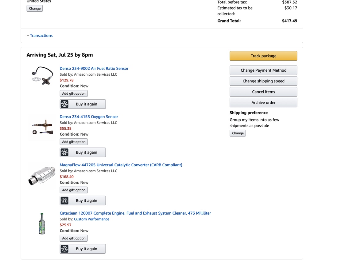

Well I pulled the trigger on these items. Fingers crossed this will make me pass the smog. If not I don’t know what I’m going to do before I break my bank account. Will keep you guys posted of my progress. Thank you! for everyone that has shimmed in! Much appreciated!

Wow yeah you'll pass now! I'm assuming you'll do the sensors yourself, they are incredibly easy once you get the old one disconnected (tip: you'll probably have to break the old wire connector from where it clips to the frame). Are you going to run the cataclean first with both old catalytic convertors and just replace the sensors or go the whole way first? A test is usually around $50 though, so if it were to fail again I guess that would kind of suck.
Update: So I did run the Cata clean with the old catalytic converters. Took the
Truck to a little muffler and catalytic converter shop so they can weld my rear catalytic converter that I purchased from amazon. The tech put the scan reader and it showed that it had P0420 code, but the check engine light was not on. The only thing is that I never reset the code before I ran it with the cata clean so I’ll never know if it worked. Went ahead and had him weld the new one for 50 dollars he also deleted the code. I literally went to the bank (3 miles max) and came back to see if any codes came on truck was ready for smog lol. Took it to the shop down the street and officially passed. Didn’t change the sensors neither.
