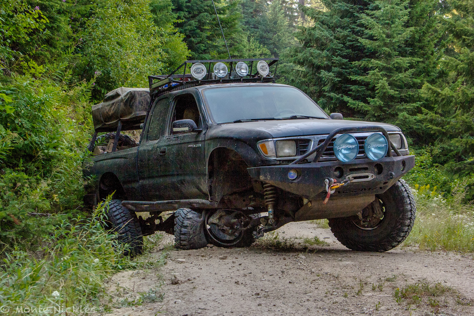

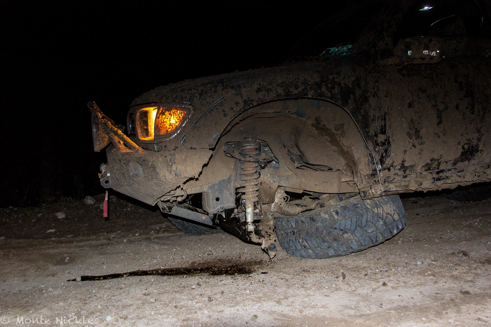

Disagree entirely. Especially because i have blow two ball joints..
It takes nothing to blow the OEM ball joints. Hundreds of people have had it happen just going down the road. Nothing big just bam and your ****ed.
Been there...twice. In a month.
Not fun.
Frank-3.jpg by Monte Nickles Photos, on Flickr
SOSMeet-17.jpg by Monte Nickles Photos, on Flickr
