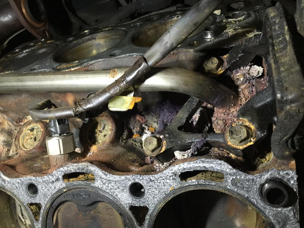

Ah, man. This is where I am at right now:Cry: Last Sunday morning I tried to start my '96 and, yep, NOPE. Lotsa bad language :tape2:, a tow truck, and a week later I am facing the same question. My Runner has 192k on it and is in pretty damn good condition other than, you know, THIS:

Jesus, that is ridiculous markup on the parts, a Fel-Pro head set for the 5VZ can be had for under 300$, and an OE TB/WP is just over 200$.
I'd tell em to eff off and take my 4Runner with me.
Maybe look into a Rebuilt motor for less and drop it in?
That's where we are on it now. Looking for a short block - the heads seem to have made it out alive but there's an awful lot of rust and crud on the block and God knows how long the da@m thing has been leaking....I just hope none of the "green stuff" found its way to the cat....:(
(Where's the "giant pit with money being tossed in" emoji???! GRRRRRRR....)
