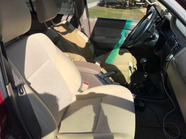

I installed what I believe were the front seats out of an 05 Subaru Forester. Got them for $50 for the pair on Craiglist. Both are tan and match fairly close to the stock interior on my runner (using a molle cover on my drivers seat in the picture). If I remember right, the outside brackets fit without modifying, but I had to use the grinder, a little bending, and some bolts for the inside brackets (Mainly the inside front bracket). Well worth the time, and luckily the wiring for the seat heaters was really simple. For some reason the driver seat is power, but the passenger is manual, but that drivers power seat was simple to wire up too. The seatbelts off the subaru seats work with our stock belt receiver as well.

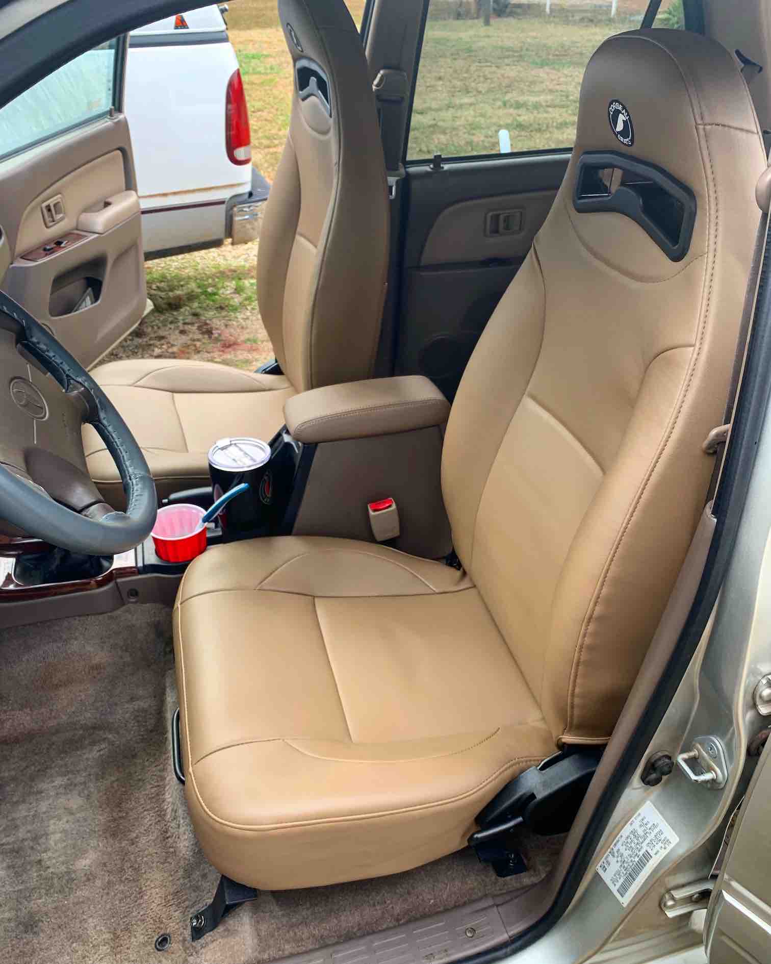

I was looking at replacement seats for a while and ended up going with Corbeau Moab seats (Color: Spice). I love them so far.

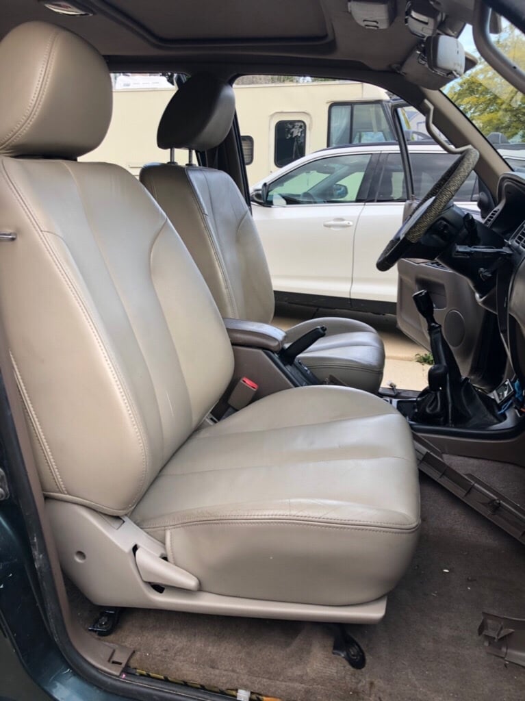

Found these for dirt cheap on craigslist, i think they are out of a murano? Electric driver and heat on both butts
