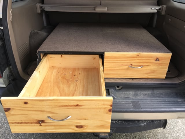

I did some searching and can find plenty of storage and sleeping pad builds but none that I saw had actual measurements included. I can find how many sq ft the trunk area is, but I need the measurement from the inside of the rear door to the back of the rear seats when they are locked in normal upright position. I have some rails that I may have access to (free from work) but since I haven't found my 4R yet I can't go measure what length I will have to make my sleeping/storage box. Anyone have that handy or can do a quick measurement?
Just went and measured for you. I'm getting 41 1/2" from closed rear hatch to back of rear seats at the floor level. About 35 1/2" to the top of the rear seats to closed back door (due to angle of the seat backs). Hope this helps. I just made this for the back of mine
