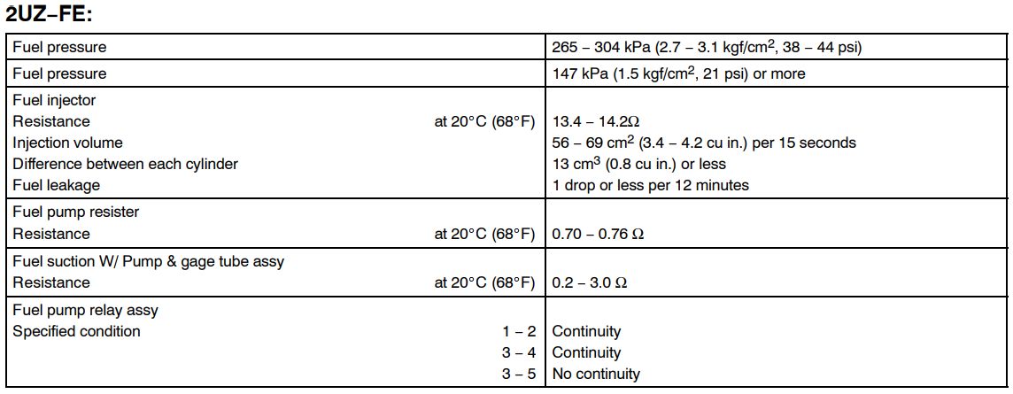

I'm really struggling after much googling to find out what the factory flow rate is on the 4.7 2UZ injectors... I'm guessing they are "250ish" (The best I can find so far was a single source on a service manual saying "224-276 cc's")

Only information I was able to find on TIS
