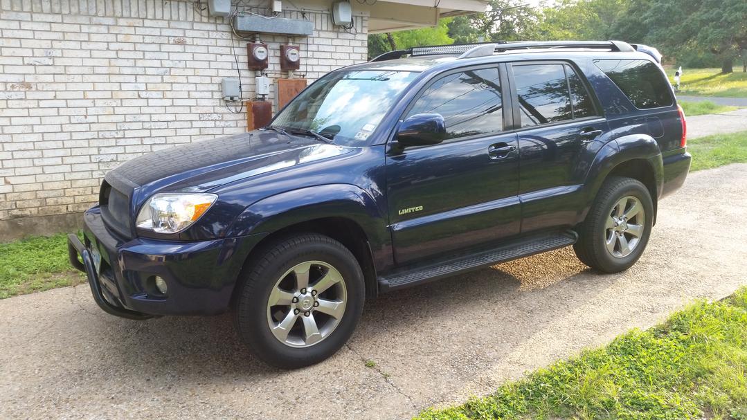

40" light bar install on the roof rack
dccgrillz
44" light bar install on the roof rack

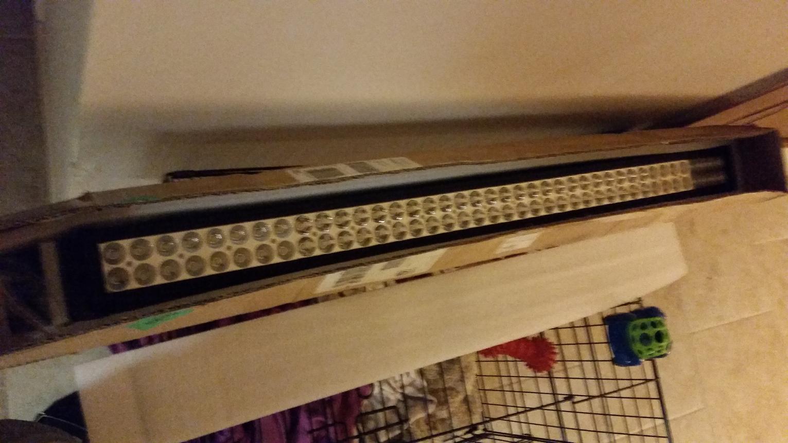

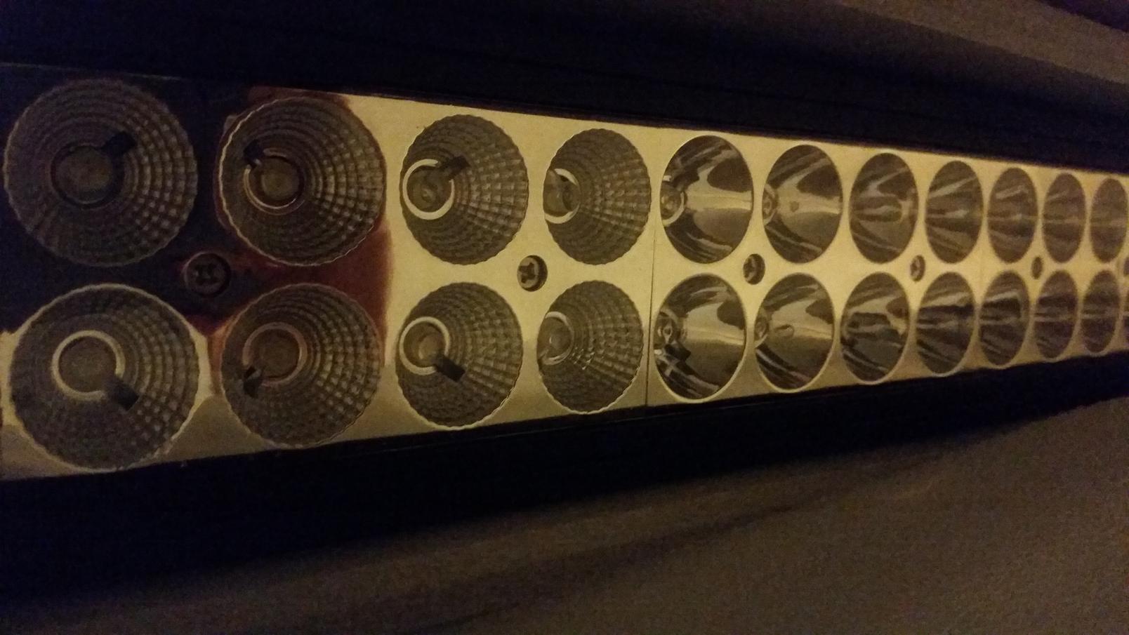

Someone on the forum was sharing their light bar install and looked like a great idea. I'm not gonna lie I am doing it for looks more than function. Hopefully it will have function too... The unit I bought on Ebay was/is a deal..
40" 40inch LED Light Bar 240W LED Work Light Flood and Spot Combo Driving Lamp | eBay
The bad news it doesn't fit in the spot I hoped it fit on my 06 limited. It almost fits just needs a bit 1/4" or less is my guess...
I'll keep ya'll posted

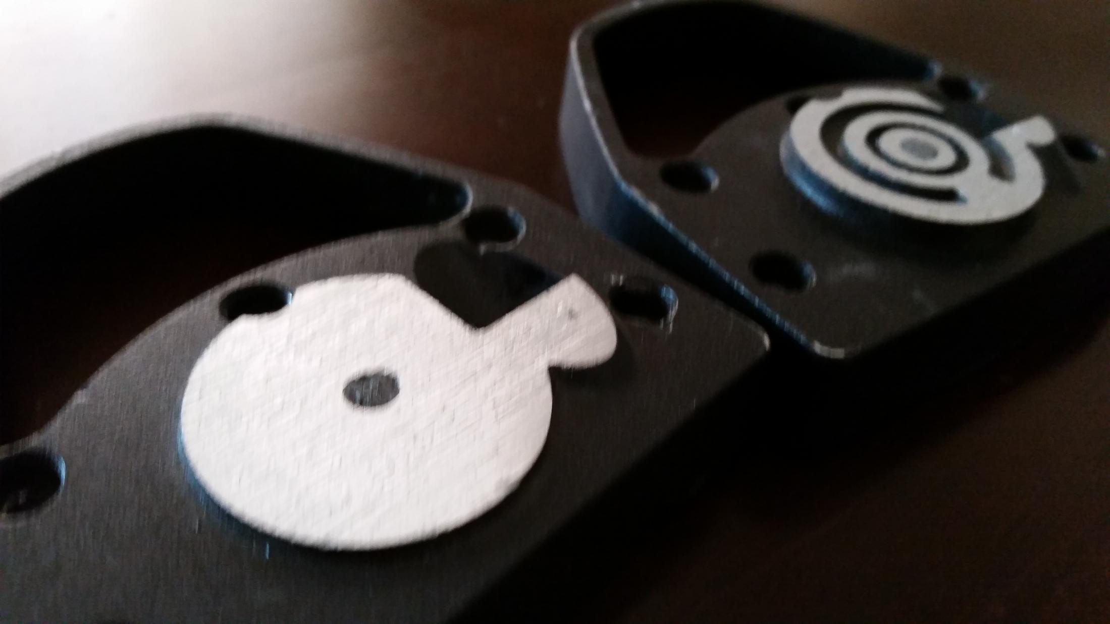

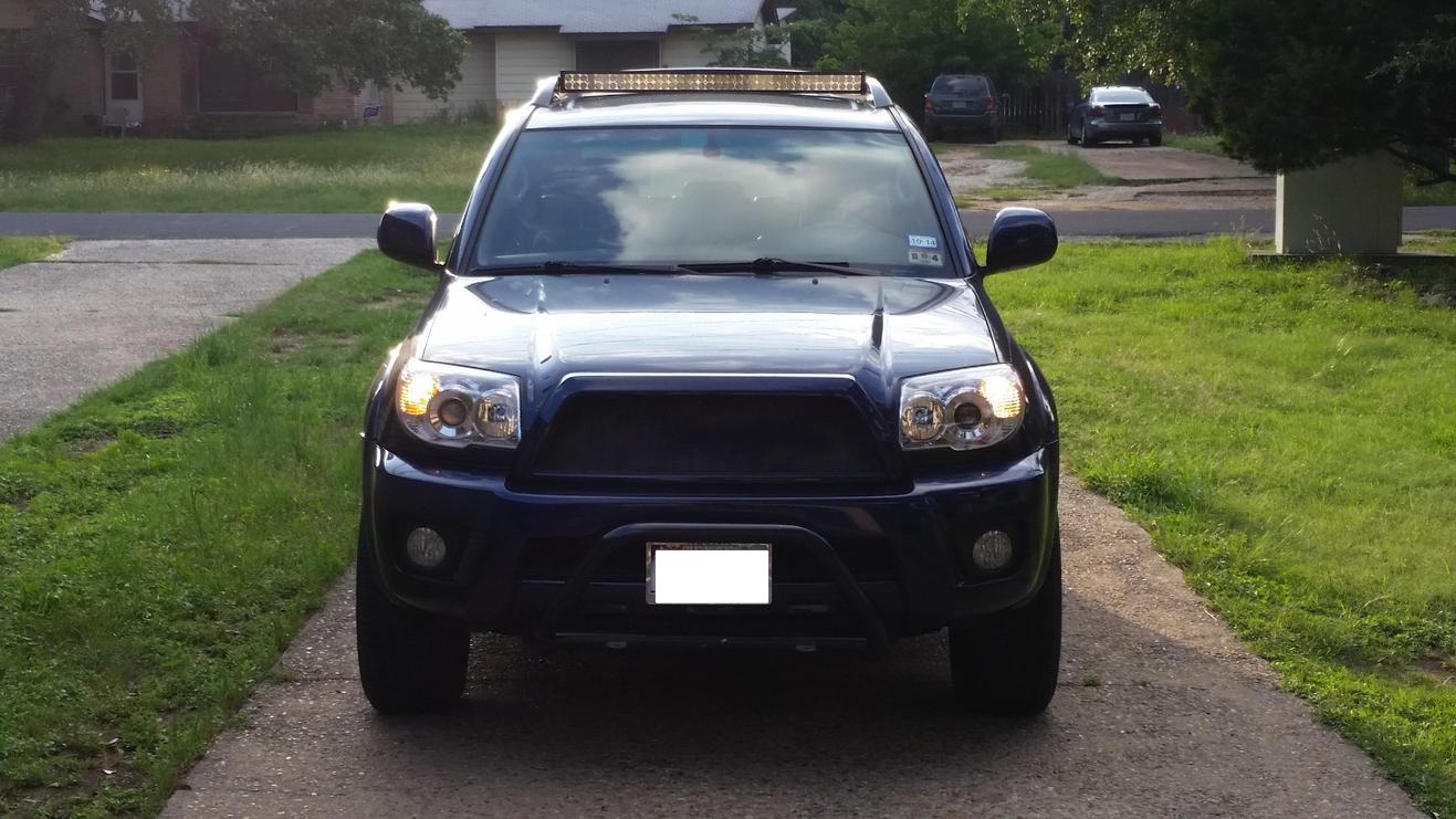

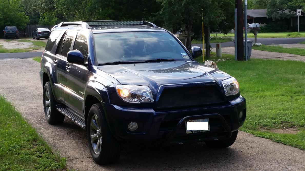

Some new progress on the light bar install
I had to shave down the end caps to make the damn thing fit between the rails. I used a file geezz it took forever....
Now....there is a high point in the center of the roof... I am not 100% sure the mounting center holes on the end caps will line up with the roof rack slots.
I just set the light on the roof and gently tapped between the roof racks tight fit...
I honestly don't care if I scratch the roof with the light a little but I don't want the light to push on the roof so much the sun roof leaks....
I will keep yall posted once I figure out a way to mount it. Need to figure out how the roof rack cosmetic caps come off to start the mounting process...

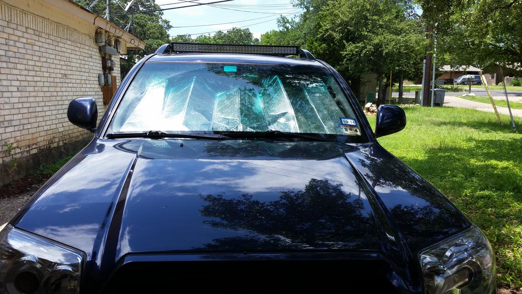

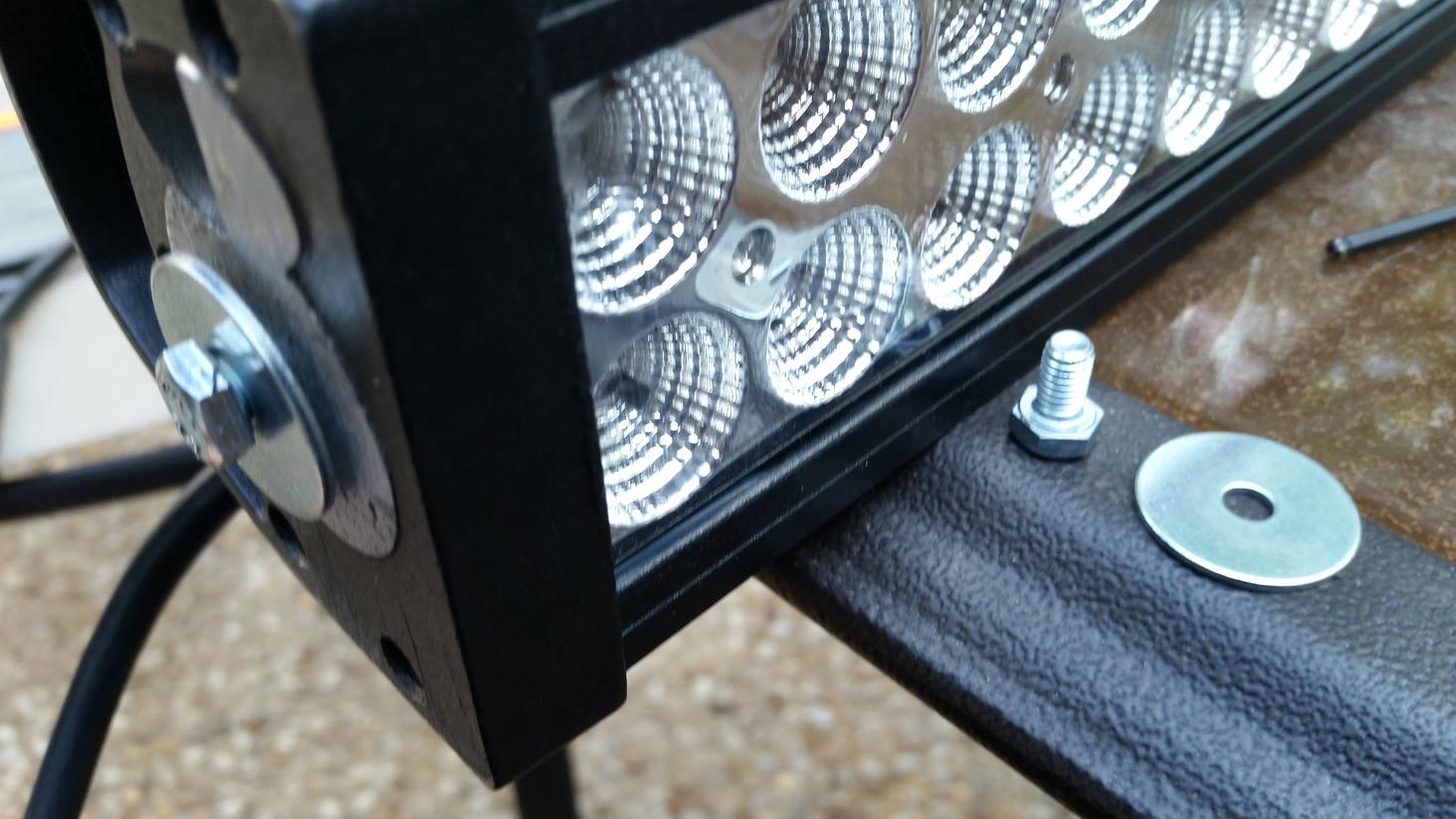

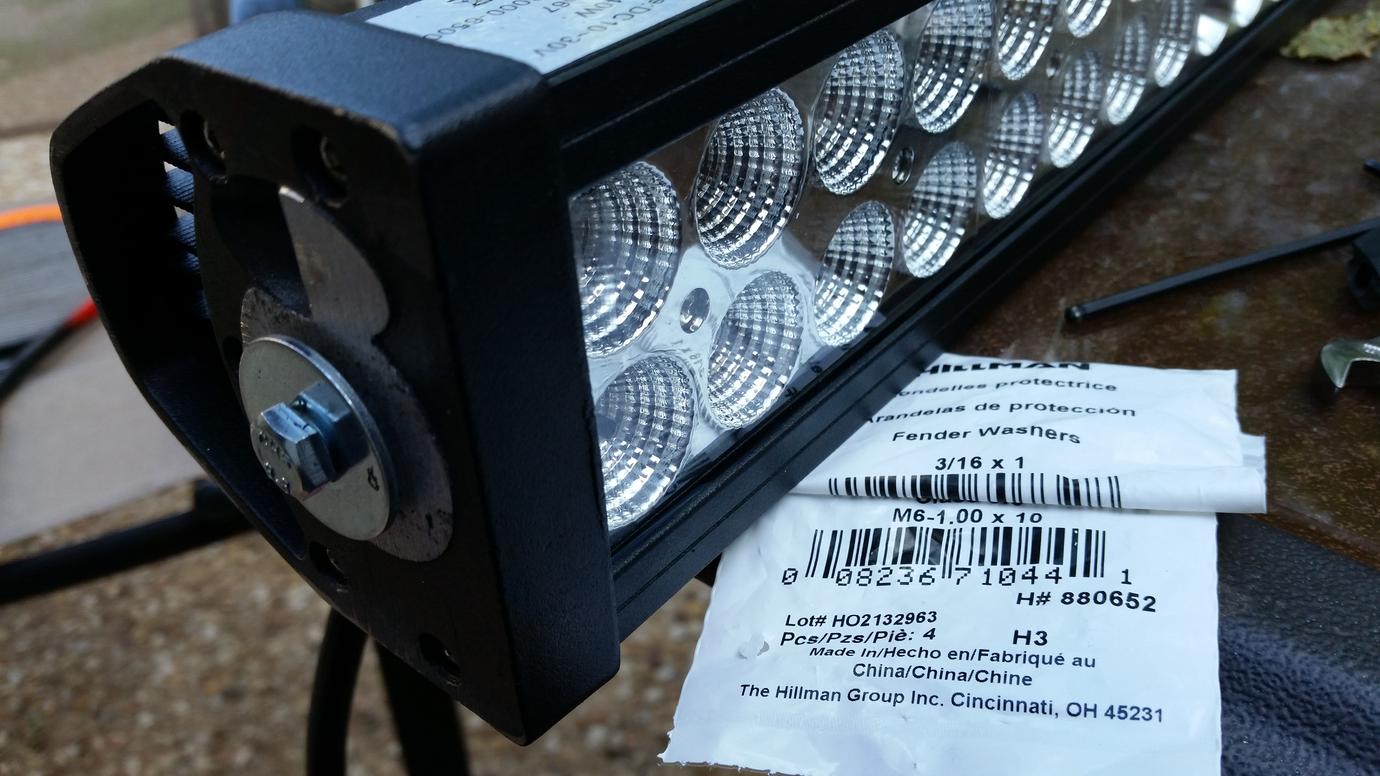

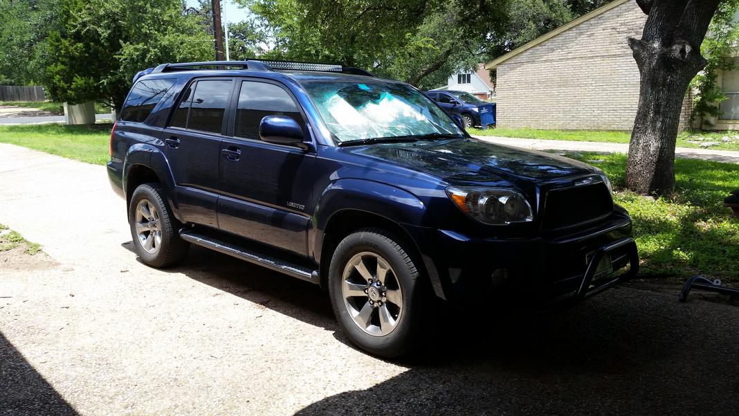

Seems to be mounted well now haven't test driven yet
The light wedges pretty tight but if you try and move it with a good amount of force and tapping it will move just a bit.
The washers fit perfect in the rack rails almost centers it (very slight up and down movement)
The light does push down on the roof in general. I think it will be fine the sun roof works fine. As I tightened the rack rails down I watched the roof line just in case but again seems fine I will water test it one day or get rained on hopefully... TX needs the rain!! Again I am sure it's fine...
Haven't test driven the truck to check for wind noise etc...
For now I want to test drive the look but I will let ya'll know how I run the wiring etc...

the bolt and washer that is bolted to the light assembly End caps are slid into the roof rack rail channel along with the extra tight fit. I had to take the front roof rail brackets/pedestals off then slide the light into the rail channels.
seems fine so far went about 75 mph no noticeable wind noise really. But tilting the sun roof is noise as hell. Sun roof open didn't seem to bad.

It's still under construction but yes there is small amount of movement... like 30 to 40 thousands. The play in the light is the washer moving up and down inside the roof rail slide channel. I have a nylon bushing idea that I planned on implementing when I do the wiring. Once I think I have it finalized I will provide the parts I end up using. Honestly so far so good as far as looks and mounting. Not sure what function the light will provide in that position since I'm the only fool that bought a 44" light...

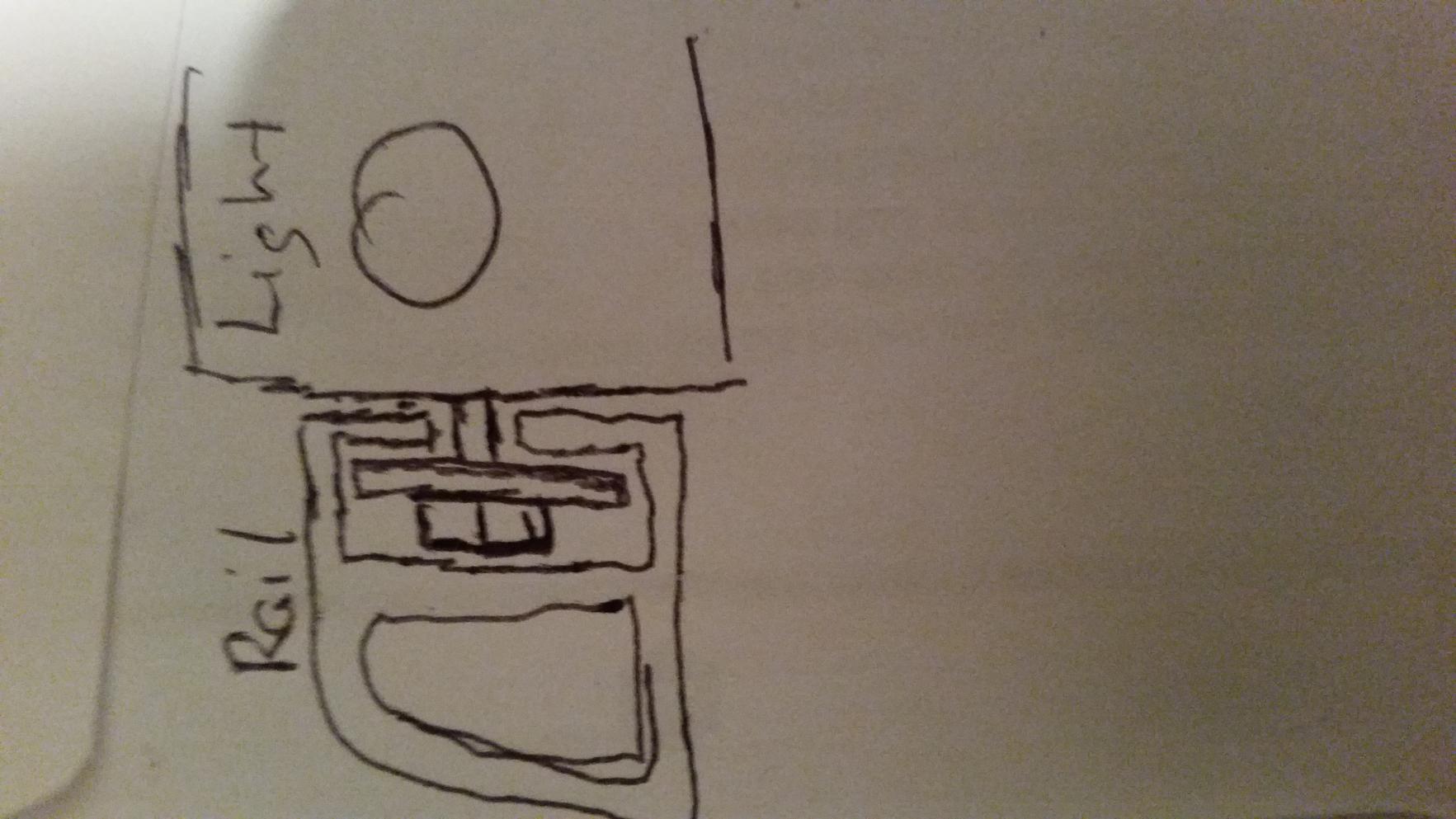

I didn't take a pic of the mounting just yet once I have it finalized I take a pic but here is a drawing of it the way it is now.
So how do you plan to actually tighten it once its inside the rail out of curiosity
I have yet to figure that out...
Right now the bolt is bottomed out tight in the light's end cap. The general fit with that length of bolt and one washer is pretty tight but again some potential movement since it's not cinched to the roof rack rail it's self. Again not sure I'd I can modify some old 10mm tool to use but I hope to figure something out.
