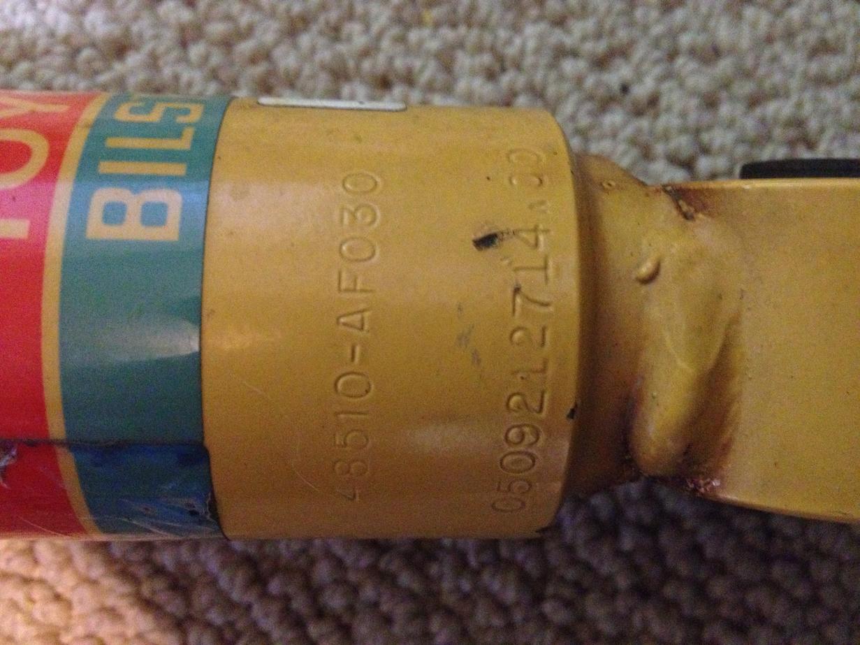

I bought the driverside trd tundra strut assembly from ebay from a used parts website. I saw the y/y on the coil and it came off a 2000-2006 TRD Tundra so i bought it. I ordered it and here it is now, when i look at the part number on the bottom of the strut it says 48510-af030. All i want to know is will this strut assembly will still give me 2.5" lift yall? I know the part number is not the same as the Driver side - 48131-AF100 Yellow/Yellow. I can still send it back I just need yalls help, Yotatech and here didnt really have threads about it. thanks fellers

I'm pretty sure those are right if those coils were attached to them. I think you will only get 1.5 inches of lift if I can remember. I believe you had to add a spacer to them to get over 2 inches.
I got 3 inches with the yy/YB springs and a 3/4 top out spacer from toytec. If I were to do it again I would just get some 5100's and adjust them to achieve the desired lift. The top out spacer makes it a pain to install the shocks.
