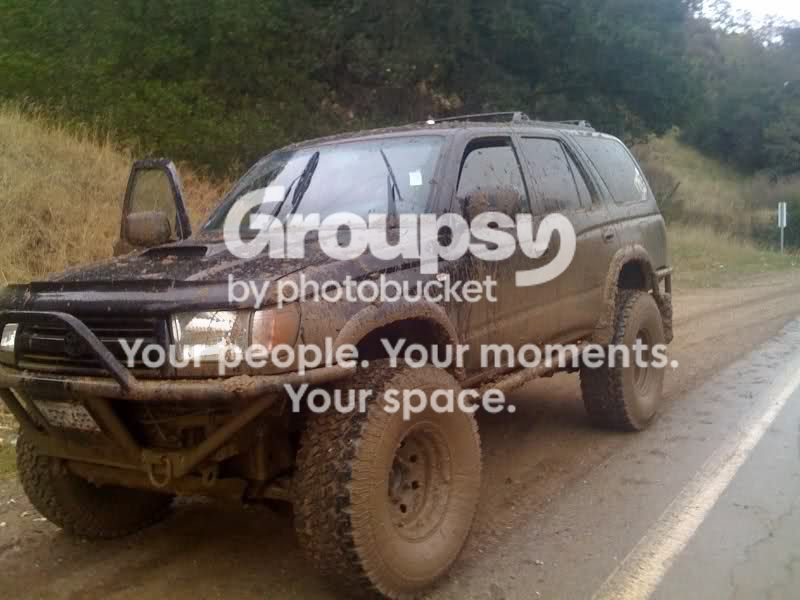

Alright, so I haven't been on this forum in years. Last time was when I had my first 4runner, but it got rolled down a hill 3 times over and a new roof welded on but obviously it was never the same and I ended up selling it for practically nothing. It was nicknamed the 4Roller by all my buddies
IMG_6172_zpsbwek7uyd.jpg~original

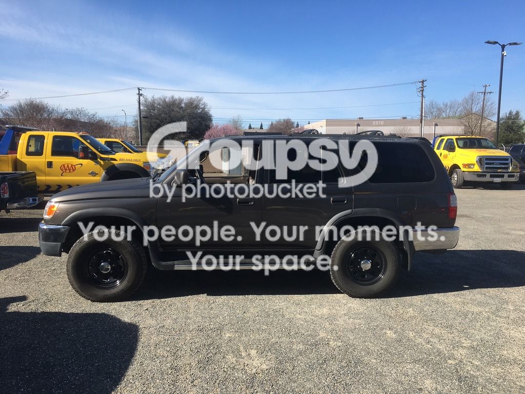

Had a couple 4runners for a minute in between then and now but never held onto them long enough to do anything. But that finally changed the other day when I picked me up a 1996 SR5 with 213,XXX on the clock for a couple grand.
IMG_6316_zpsjmlnys8k.jpg~original

So I finally got the suspension put on.

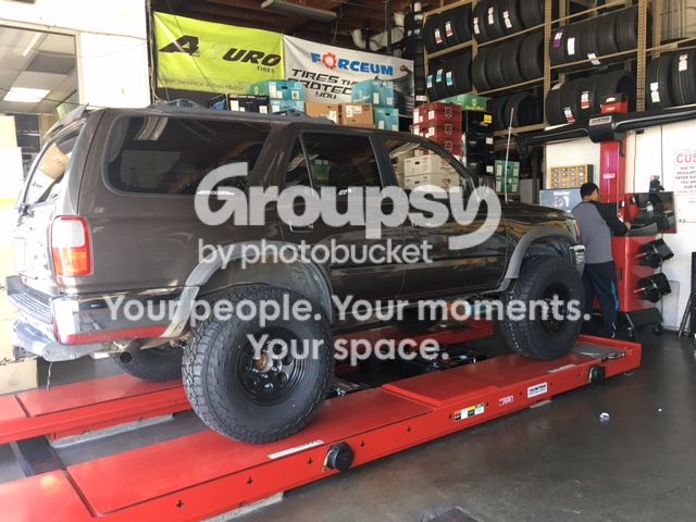

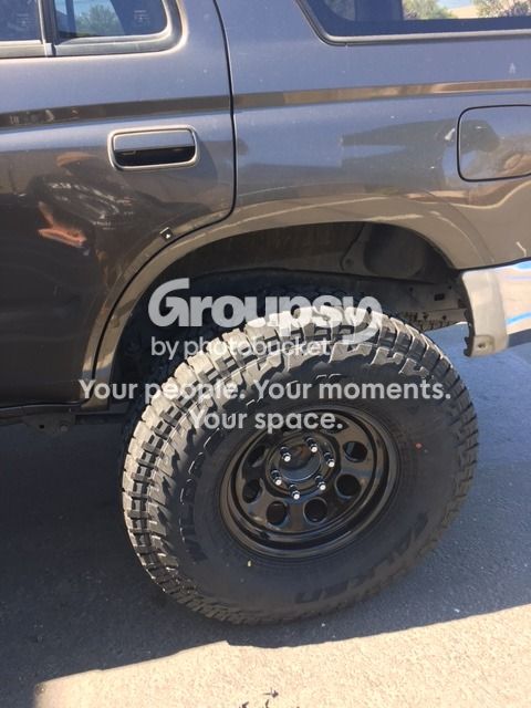

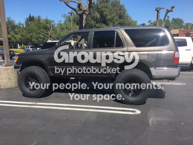

Finally got tires, decided to go with the AT3 instead of the M/T.
So here they are Falken Wildpeak AT3 315/75R16.
Also took off the steps, fender flares and the lower valance on the front bumper. Only place its rubbing right now is the back of the front fender which will be address in the next couple days. I still have the body that might or might not go on depending on how clearances go.
