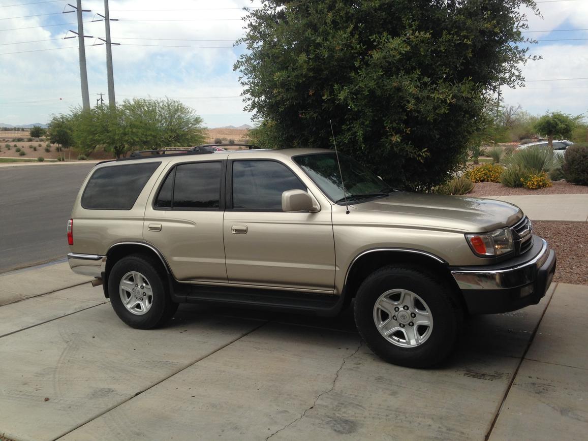

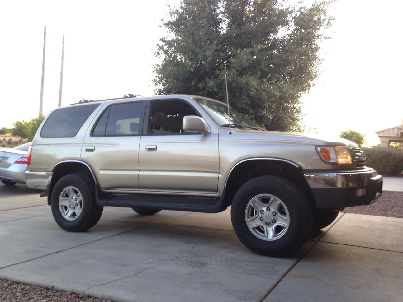

I just installed 4 new coils (moog 96-00) and 4 new shocks absorber kyb monomax. I did not measure before but I gain like 2.5"

It had 186000 on original suspensions. The difference is like day and night. Now, the ride is very stiff, It doesn't bounce anymore.

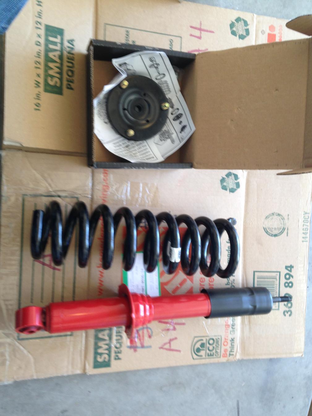

I thought on getting an emu or toytec but right now I'm short on money. After a big research, and because my truck urged new suspensions I ended up buying these:
Moog Front Coil Set 81088 96-00 $54.49
Moog Rear Coil Set 81041 96-00 $38.40
4 KYB Monomax F&R 236.99
KYB Strut Mount set SM5184 $59.23
I rented the spring compressor at autozone and did the job myself.

Hi, It has been almost 10,000 miles. I go off-roading every month. So far it is holding well, I don't have any sag at all. Here is a picture that I posted of how the truck looks after the suspension was installed. http://www.toyota-4runner.org/3rd-gen-t4rs/198024-ko2-265-75-16-installed.html#post2028337
I did a lot of research and this setup was the best that I could buy with less money. Once these one wears out I'm planning on going with Bilstein or something similar but for now I will push this one as far as I can.

Wow! It sits pretty level too! So ride is good...not harsh? It looks like all of the springs listed for those years have the same spring rates. The only differences I see on the Federal Mogul site are the lengths...with the part #'s you list being the tallest.
I'm really surprised others haven't done this lift since it's pretty cheap and seems like the spring rates are in line with factory?!?
